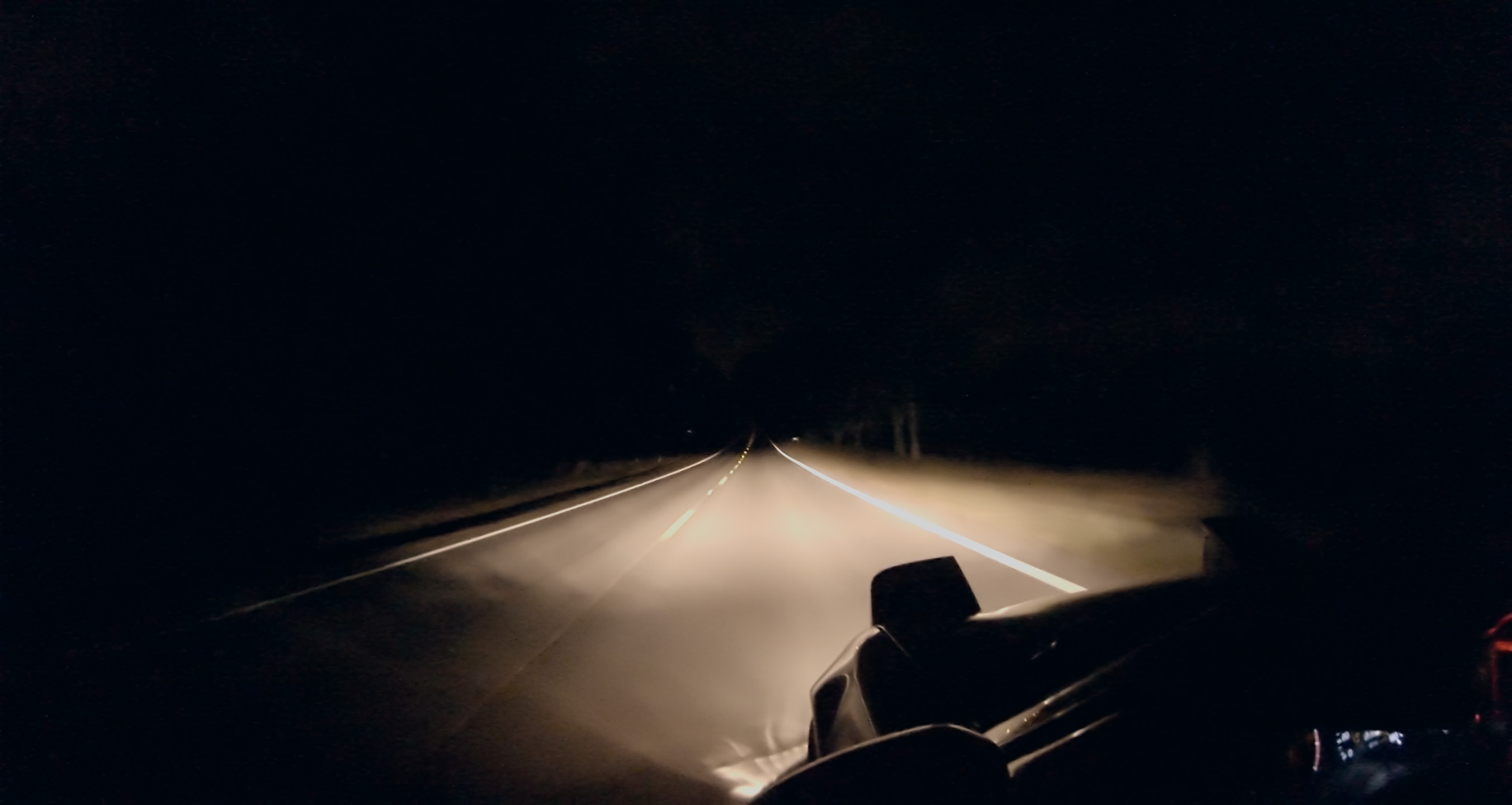

    Playing around with 5DtoRGB. I had previously directly imported the MP4 file into After Effects. This time, I brought it into 5D first, then AE. What I found is that you get a much flatter image running it through 5D first, using 601. And it's not just a gamma shift, as I tried to bring the shadows back up in the original MP4, but all there was left was chunky noise. Here's a sample with Neat Video and slight color correction, same settings applied to both, with slightly tweaked NR for the 5D version's additional detail (tried not to blur it to death):
    GoPro MP4:
    http://www.personal-view.com/talks/uploads/FileUpload/6f/73e8300280e05b1ccec2569c29edfa.jpg
    5DtoRGB ProRes 422 HQ 601:
    http://www.personal-view.com/talks/uploads/FileUpload/40/f7b237ef2ee0cf0a7fbd2811686936.jpg
    You can easily see the separation of the trees from the sky now, and the center of the headlight beam isn't about to be blown out. For the other settings, 709 has very little effect beyond shifting colors a bit (reds look more accurate, insignificant mids boost), and Full/Broadcast Range has zero effect.
    2704 x 1440 - 295K
    2704 x 1440 - 387K
