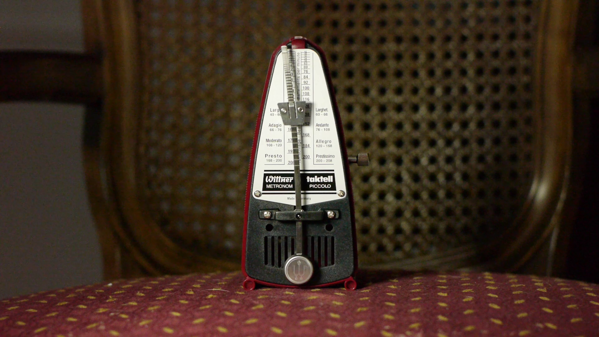

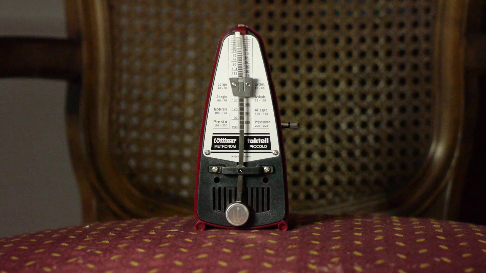

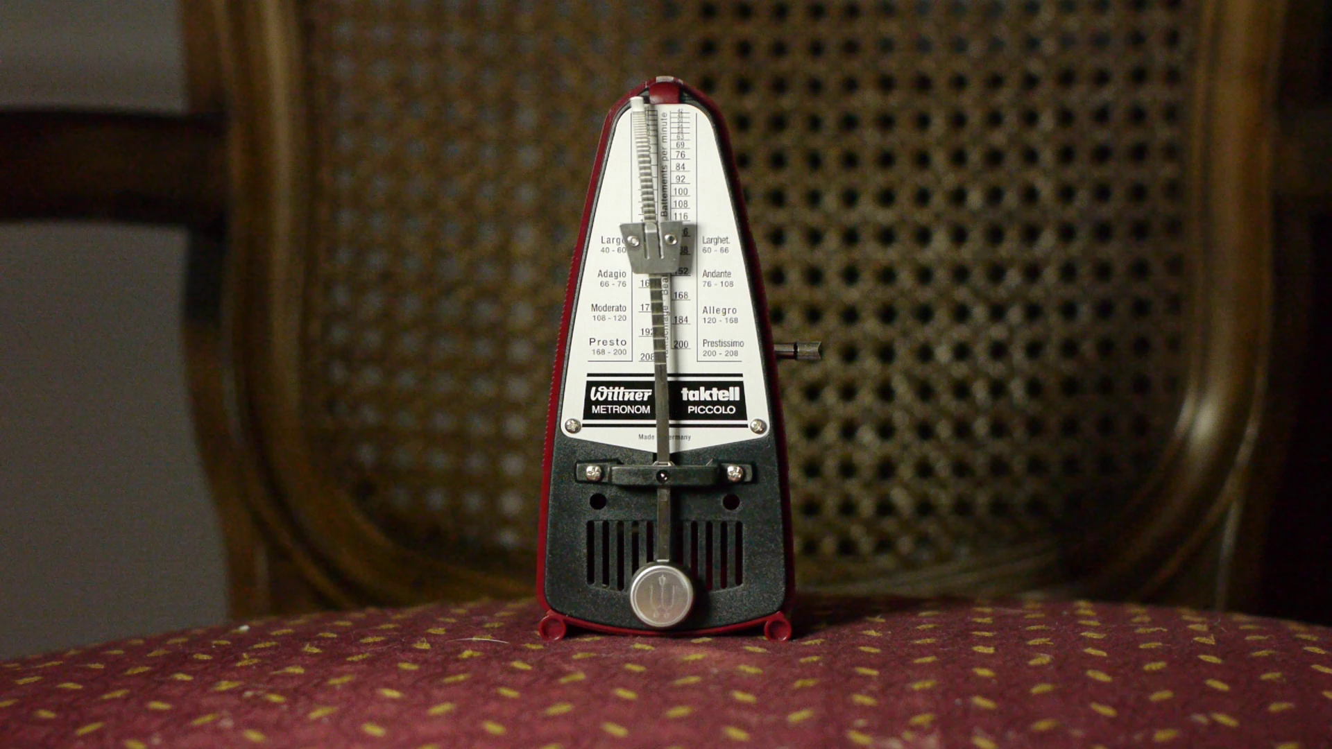

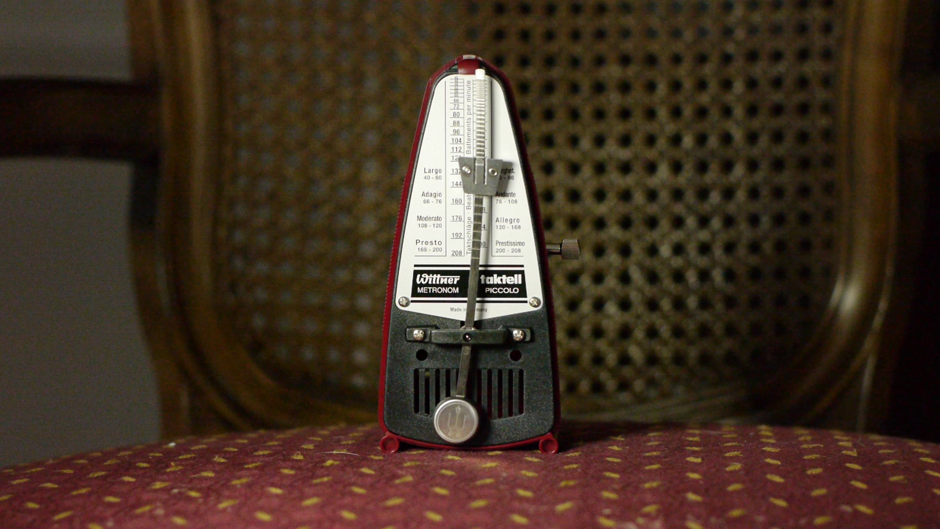

  • Have you guys ever considered that all the low GOP setting could be doing is making the codec less efficient? You could just be recording the exact same thing at a higher bit rate and with much less reliability.
    There is a good reason why they created I,P, and B frames. They each help to efficiently encode the video in different situations. You are totally eliminating one of those components without regard to what that actually does to the video. Who knows it may help. It may not. We won’t know that until you really test it against the same settings with a higher GOP.
    Here is a good example of what I mean.
    This first picture is the standard 1080p @ 24 FPS LOW bit rate of 18 mb/sec.
    http://www.personal-view.com/talks/uploads/FileUpload/0f/d68a022d696229b350d32909d5d982.png
    The second picture is with the default low 18 mb/sec patch and a GOP of 3.
    http://www.personal-view.com/talks/uploads/FileUpload/42/afa9d60637cfd70efdb89e51539e10.png
    The low GOP 18 mb/sec picture is clearly worse than the higher GOP video. Now neither of these are really that great. However something like the pictures below looks much better. Can you tell which one of the pictures below is 32 mb/sec and which one is 42 mb/sec?
    http://www.personal-view.com/talks/uploads/FileUpload/01/4113c817ca179ebce89610e6202bcd.png
    http://www.personal-view.com/talks/uploads/FileUpload/92/efd44efc8f352acda7a96165e76572.png
  • first is 42 mb/sec
  • @mpgxsvcd Short-GOP encoding is definitely less efficient than long-GOP. That's why professional Blu-ray encoders use GOP-lengths over one second long. However, the challenges that a resource limited, in-camera AVCHD encoder may face can be far more demanding.
    The fundamental dilemma is that B-frames use both forward and backward motion vectors, and no real-time encoder can predict the future. Blu-ray encoders side-step this problem by making multiple passes through the prerecorded video stream, enabling them to accurately predict the bitrate needed to encode each GOP. This allows them to expertly juggle I, P, and B frame sizes to maximize both image quality and coding efficiency within the specified bitrate limits.
    A real-time AVCHD encoder is severely constrained by the limited amount of time in which it must write each GOP sequentially to the SD card. This forces it to use only the most efficient coding techniques that are guaranteed to produce correctly-encoded frames within its strictly-enforced deadlines. To do so, it must use estimated I-frame macroblock quantization factors that have a good chance of efficiently handling all object motion for the duration of each GOP. The longer the GOP-length, the more likely it is that these estimates will fall short of accurately predicting the movements that will actually occur in the video.
    Where this encoding problem can become visible is not in the type of scenes pictured in your examples. Static shots with few moving objects contain large amounts of stable image detail that are easily compressed into either P or B frames. What really challenges the encoder are scenes that contain myriads of independently moving details, for example, panning across a sunlit, churning stream of water shot in sharp focus with minimal motion blur at a high shutter speed.
    The advantage of short-GOP recording in that situation is easy to understand: the amount of motion that can occur within each GOP is restricted to the limited time duration of the GOP. With a 3-frame GOP at 24fps, each GOP is only 1/8th second long, compared to the half-second GOP-length of the unhacked AVCHD encoder. A 3-frame GOP reduces the amount of frame-to-frame discrepancies that must be encoded into each B-frame and thus greatly simplifies the encoding challenges. However, in order to maintain excellent image quality, the high rate of I-frames demands a significant increase in bitrate requirements, which explains why your 18Mbps 3-frame GOP example does not look very good.
  • @LPowell
    B frame is fully used in realtime encoder and future P frame is already in buffer during B frame encoding.
    If you change GOP, frame-to-frame difference do not change (it changes only of you change fps, so 60fps can be better for motion estimation).
  • 1st is 42 2nd is 32 .You def see the difference in the darker spot on the chair on the rx side.
  • @Alex_K and @chef
    No actually the first picture(4113c817ca179ebce89610e6202bcd.png) is 32 mb/sec and the second picture(efd44efc8f352acda7a96165e76572.png) is 42 mb/sec. You can see the pictures and the key in the first post on the link below. Now this doesn't mean that in every scenario you will get the same results. However, my testing has shown that the differences between 32 mb/sec and 42 mb/sec are not as great as some people have lead us to believe.
    http://www.personal-view.com/talks/discussion/541/the-zero-adverse-affects-hack-thread#Item_19
  • @Vitaliy_Kiselev
    Yes, on the GH2, I suspect a 6-frame GOP (IBBPBB) would work just as well as a 3-frame GOP, and produce more efficiently encoded files. Where the encoder hits the wall is when P or B-frame size starts to exceed the size of I-frames. I've seen this occur during quick panning at fast shutter speeds.
  • @LPowell
    I agree with your statements. That is all accurate. However, I question whether going to GOP = 3 is worth it because it eliminates the P frames. If the quantization tables are setup based on the presence of P-frames you could theoretically throw the whole thing out of whack. That is what I am seeing at 32 mb/sec and below.
    Your point about needing much higher bit rates in order to lower the GOP is absolutely correct. However, we can’t really determine whether getting rid of P frames is detrimental without 1 to 1 comparisons.
    I didn’t have time to test all of the different scenarios so I just tested the ones that are 100% stable. I hope someone else has the time to do a proper test with the extreme bit rates and lower GOPs. I hope that those settings do produce a beneficial and visual improvement. However, I am not going to blindly accept that they are better until I see a scientific test that shows how they are better.
