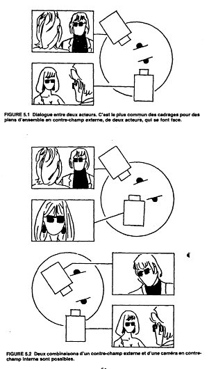

  • More on setting up interviews for choosing lens, (also mic and lighting purposes, seating heights..)
    *from Daniel Arijon, "Grammaire du langage filmé"
    Note:
    • 2 cameras are cheap these days, no longer a real need to do a second take with same camera for "noddy" reverse shots of the interviewer;
    • The other camera (or even a third) is needed for a 2-shot or "Master shot" from the front, for something to cut to if, say, the talent leans forward and out-of-frame to reach for a glass of water, or stand up, or make out-of-frame gestures;
    • As @rambo says, the A-cam (MCU or CU of talent, shot over the interviewer's shoulder) needs to be locked-on. If the back of the' interviewer's head moves slightly into frame, partly obscuring the talent's face, the lens will hold its focus instead of focusing on the interviewer and blurring the talent.
  • Setting up for interviews itself - before the interviewer and talent arrive - has never been more affordable either: as students we used foam heads on sticks (much more tolerant than live stand-in people). Now there are cheap, realistic, life-sized busts. (try googling images for "foam mannequin bust")
    Foam (jewellery) mannequin busts are better than plain (wig) heads because they have shoulders - for when you need to keep the interviewer's shoulders out of a shot of the talent. Mannequin wigs are cheap, too. Very important for sight-lines with long-haired subjects.
