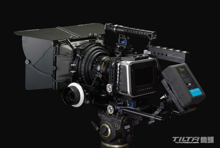

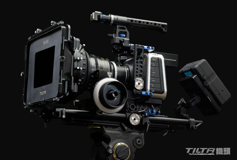

  • Tilta rig for BMC camera (19mm rails, complete with double FF, and MB)
    772 x 520 - 87K
    772 x 520 - 83K
  • on the video above it looks huge.. is it the same as attached on the BMD CC? Someone told that Tilta has the same baseplate mount as Sachter. Can anybody confirm this? Thanks in advance

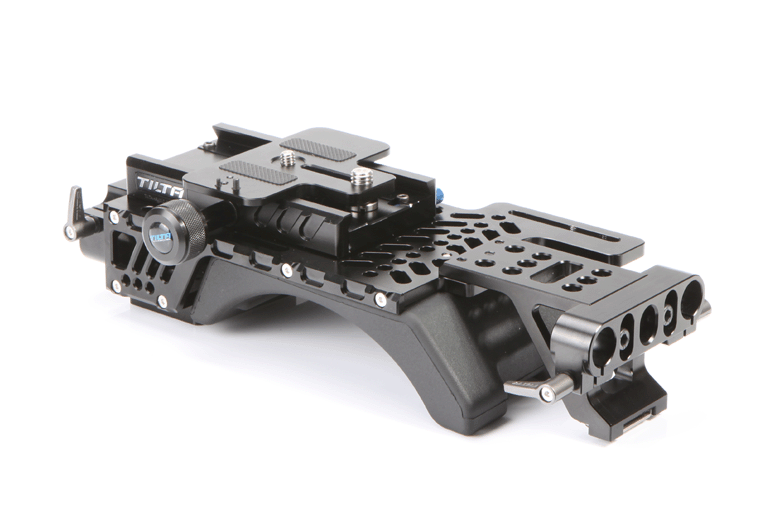

  • Just got my Tilta BS-T03 shoulder base. Shipping is fast, one week from payment to delivery (with one day of public holiday in the middle).
    Same overall build quality as their follow focus kit, everything is nicely made, well thought and sturdy. The product in itself is a killer, lightweight (100 grams lighter than Lanparte base plate + shoulder pad + 2 x 30 mm rails, and those do not attach to a VCT-U14), low profile, it is WAY easier to balance a rig with it than with a separate shoulder pad and camera base. Less counterweight force required means the overall weight and inertia of the rig also goes down. To me, Tilta pad feels more comfortable than Lanparte pad.
    Overall it's a pleasure to carry on your shoulder, almost feels like a DSR450.
    Things not shown on the picture :
    • it comes with 2 x 10 mm and 2 x 20 mm rods + 2 x connectors.
    • the shoulder pad can be adjusted back and forth via a pair of hex screws (25mm range)
    • the version shipped has the new, updated camera plate shown below (I prefer this system, as I lost pretty quickly the two very small "blocking pins" on my follow focus baseplate).
