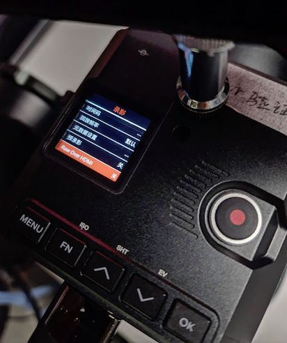

  • Zcam told me that RAW come very very soon
  • @flash
    Who told you this?
    Z-CAM raw that is really not raw? More new formats?

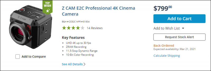

  • Highlights of Z CAM E2C:
    • 4K 30fps / 1080p 60fps, 11.5 stops dynamic range
    • H.265 10 bit color, H.264 8 bit color
    • 4/3″ Sony CMOS sensor, MFT lens mount
    • PoE (Power over Ethernet) is supported
    • WiFi, Ethernet port, LANC remote, USB-C
    • 4K HDMI output
    • Recording: SD card or SSD (via USB-C)
    • Power: Canon LP-E6 & LEMO port
    • Button configuration (same as Z CAM E2)
    • Shoulder LCD (same as Z CAM E2)
    • Live streaming via Z CAM iOS app and PC software
    • ProRes recording on SSD via USB-C (pending on license approval)
    • RAW recording on SSD via USB-C (under development)
    • Z-Log2/FLAT/sRGB
    • Smaller form factor then Z CAM E2
    MSRP: USD799.00
    shipping fee will be added
    Target ship date: March 2019.
    Early bird price is 699,-
    This is more of the proper way.
  • @kurth thanks, that's good news, hard to find info on the E2c!

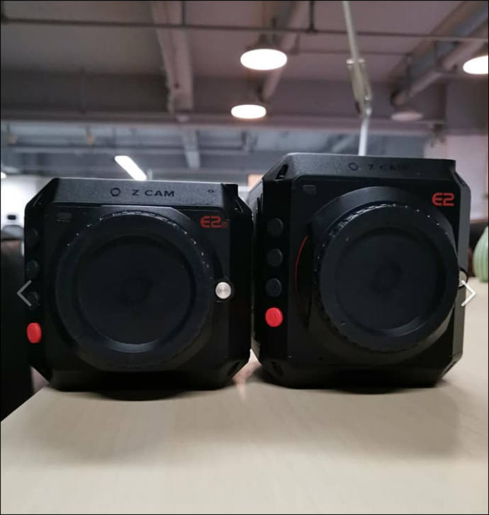

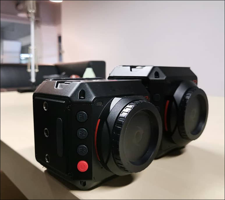

    1. It will be still E2 series as we mainly changed the sensor. If you put the cameras together you will finally found them almost the same. They will be of similar size. Small body is the key. We want to build a series of handheld powerful cameras.
    2. S35 version can do up to 6K60fps.
    3. S35 version can do 6K30/60fps sensor input and then down scaled to 4K30/60fps recording. Super sampling recording is amazing.
    4. Target mass production is October. We set 3 target mass production target in the past for different products and we delivered them.
    5. All E2 series cameras share the same codes if it's not feasible with that sensor so it has all features E2 has(resolution/framerates are not in this claim).
    6. Planning EF/PL mount with active lock for many reasons.: a. We planed short flange mount before and we found E mount isn't an option for 3rd party camera makers. The new mounts are lack of lenses(waiting to be proved) and also not open to welcome 3rd party to join. b. exchangeable lens mount needs more space which means the camera needs to be bigger. And also we don't think user can make short flange lense mount FLAT enough. If you make a test on E2 you will find E2's flange is the most accurate one in all M43 cameras that all the cameras have exactly the same flange. The shorter flange the edge blur issue will be more serious if we open it to user for exchange. c. If we make an own standard we need to make all the adapters by ourselves, and that's not possible to set up ecosystem. We are still open to suggestions.
    7. If an accessory works for E2 it should work with E2 S35.
