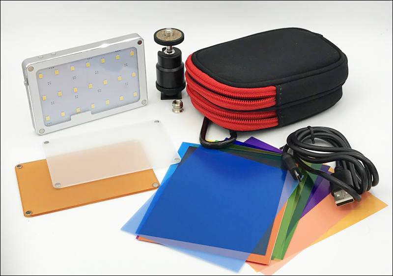

  • Specs
    Package Includes:
    • 1 x LED Light
    • 1 x Universal cold shoe mount
    • 1 x USB charging cable
    • 1 x Soft light diffuser
    • 1 x 3200K Diffuser
    • 1 x Carrying case
    • 12 x Color Gel
    • 1 x Product Manual

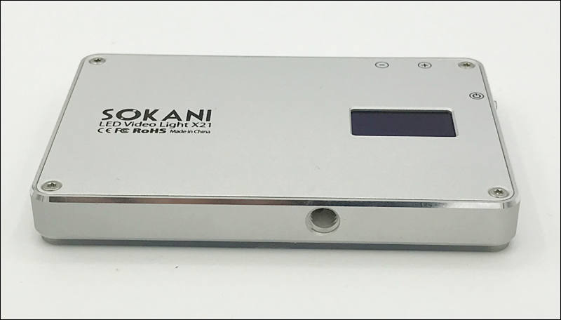

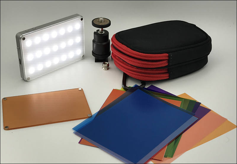

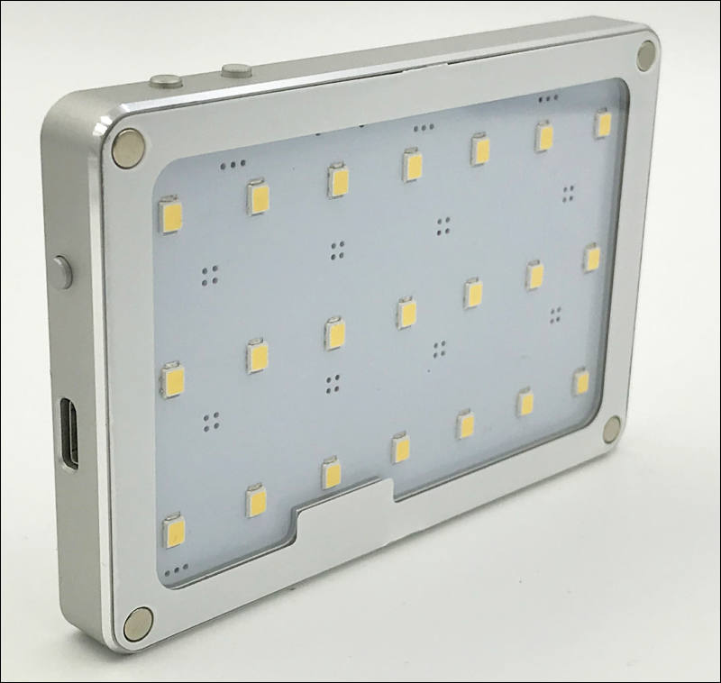

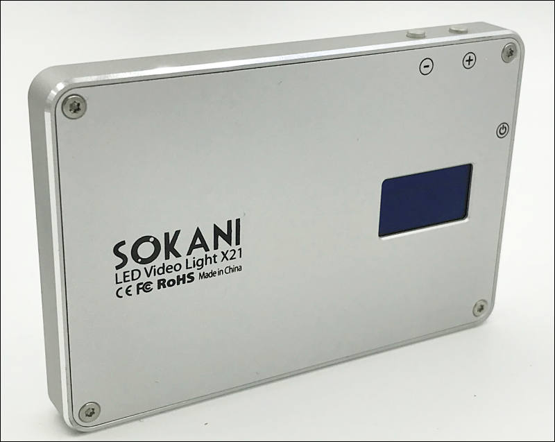

    The Sokani X21 LED Video Light is a nicely built rechargeable light than is not expensive at $50. It is machined out of metal unlike a lot of other inexpensive lights which are made out of plastic or composites. It is light weight at 100 grams and comes with 2 magnetic filters. One is a diffuser filter and the other is a 3200k diffuser filter for the 21 daylight LED’s. It also comes with 12 color gels for sandwiching in-between the magnetic filters and the unit, a universal cold shoe mount, a USB charging cable and nice carrying case.
    After charging, you turn on the light with the left side power switch by pressing in for 2 seconds. The OLED display on the back comes on and it displays the battery usage and brightness percentage. Hit the power button again on the LED’s come on. There are 2 buttons on the top to vary the brightness of the LED’s. Looking at the back, the left button is for lowering the brightness and the right one for increasing the brightness. Simple. There is a 1/4 inch thread for mounting on the cold shoe mount.
    This light feel very durable and the magnets are a nice touch for mounting filters. Also it is very small because of built-in rechargeable batteries. A really nice little video light.

  • I just got the couple that I ordered.
    Like the M9 and the little GVBGear, they are really bright! One bummer is that the included color gels aren't cut to a size that will fit in the carry pouch (the ones included with the other lights are). Not a big deal - I own scissors, but it would be a nice touch to have the filters fit better in the case.
    Otherwise, I haven't had much of a chance to play - but I'm excited! I think they're the brightest of the bunch so far - at least, they hurt my eyes more than the other two. :)
  • One bummer is that the included color gels aren't cut to a size that will fit in the carry pouch (the ones included with the other lights are). Not a big deal - I own scissors, but it would be a nice touch to have the filters fit better in the case.
    Yep, you can see it on photos above. I'll tell manufacturer.

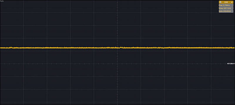

  • And here is Sokani X21 - proper good behavior
    note that initial small intensity drop is not due to controller, but due to leds heating up
    800 x 523 - 56K

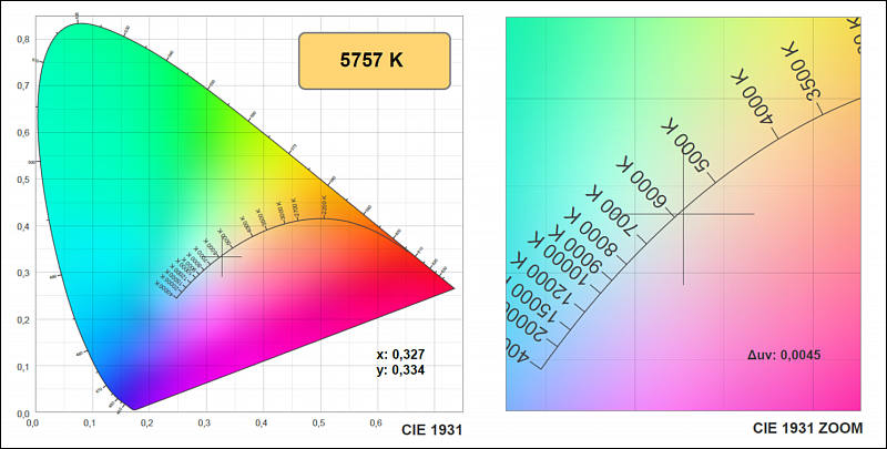

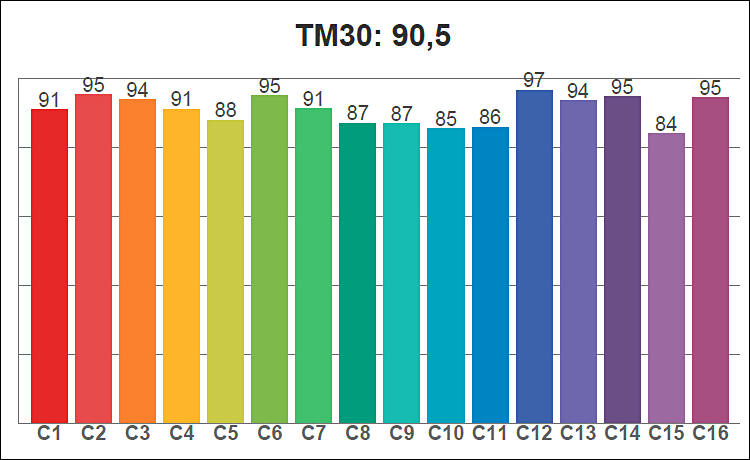

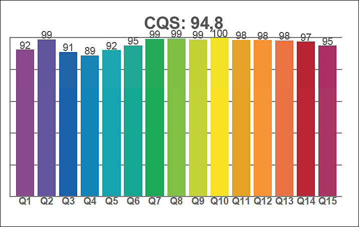

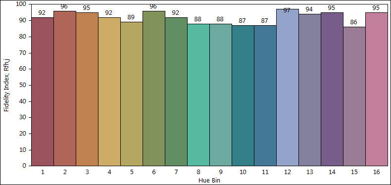

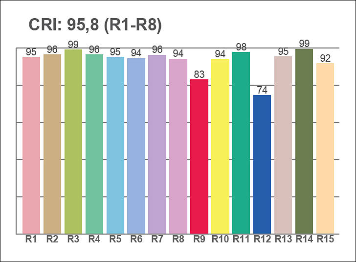

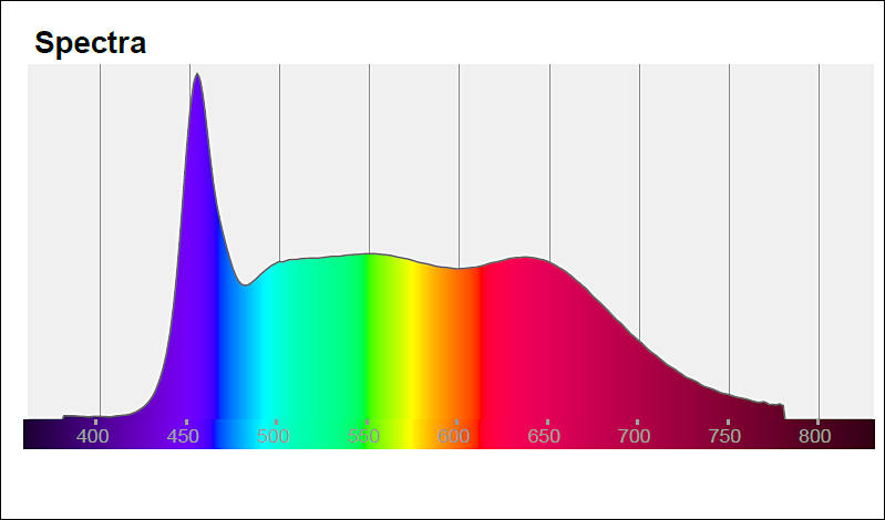

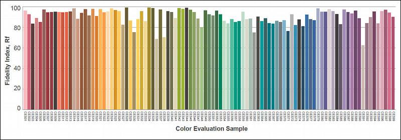

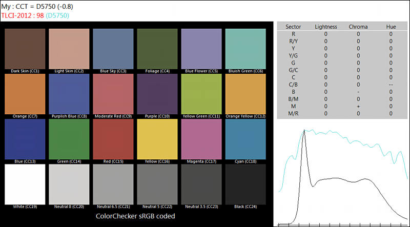

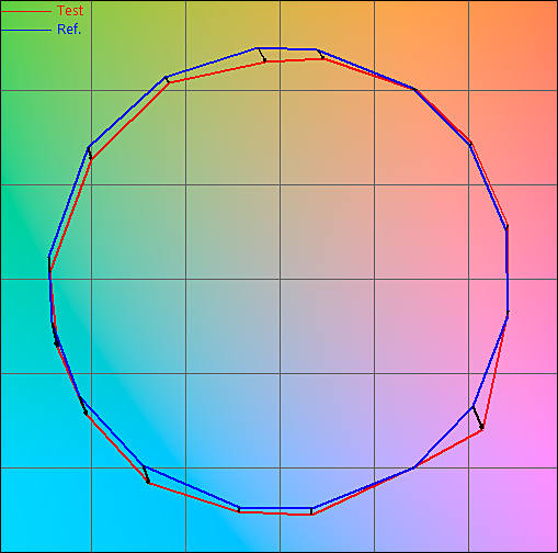

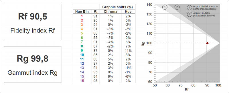

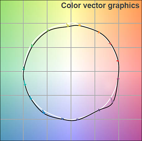

  • Spectrum and CRI
    Sokani X21 (Daylight), Measurement using CV600, Russian Lab processing
    Focus on TM30 and CIE 224 and look for color distortion and Rf values.
    Sokani X21 is good light with light quality suitable for videos.
    Color temperature
    CRI color quality
    CQS color quality
    TLCI 2012
    TM30 color quality
    TM30 details
    CIE 224 2017
    Support us to see more info like this - https://www.patreon.com/personal_view
    799 x 470 - 35K

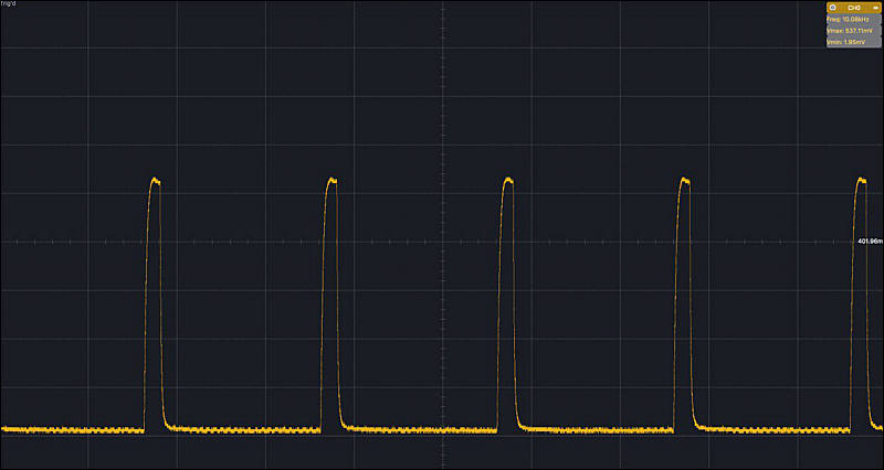

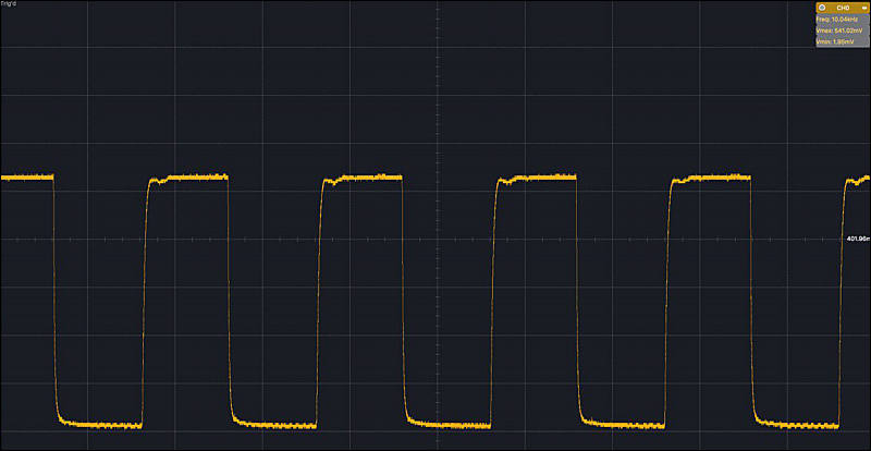

  • Sokani PWM at around 50%
    PWM Frequency is 10Khz
    Sokani PWM at 100% (battery at not at full fresh charge)
    You can see that controller drives leds at maximum always.
    See above that controller CAN keep output level properly.

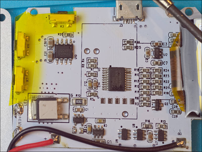

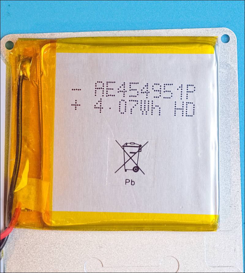

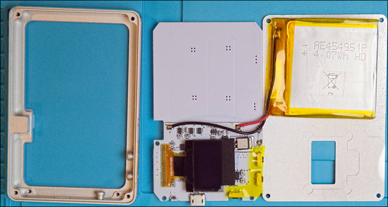

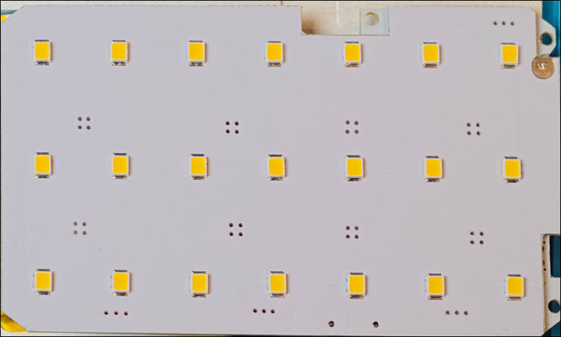

  • Sokani X21 inside
    Really nice construction with alu case, nice quality board, battery is 4.07WH and could be larger.
    Board with leds
    Vent holes are quite small.
    Battery - not bad, but could be slightly larger capacity
    Main board
    Very nice soldering and overall quality and design.

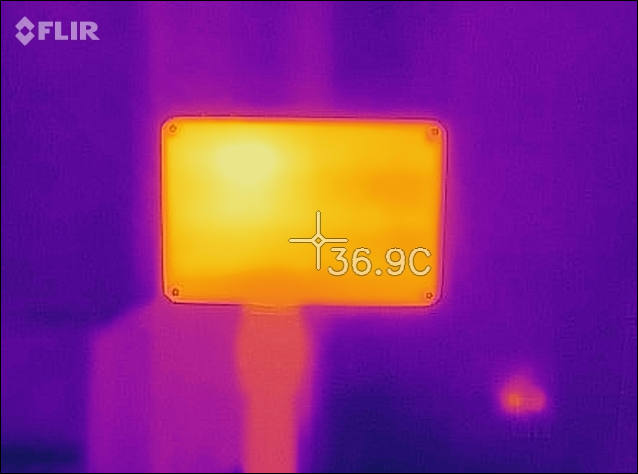

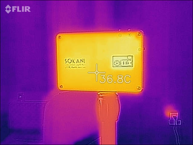

  • Thermal photos
    Hottest part is board inside and OLED screen
    638 x 474 - 29K
    639 x 478 - 35K
