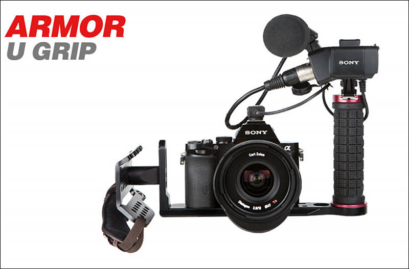

As far as I remember on ebay you can find cheap metal things made for mounting two cameras or such, in the middle they have mount point for monopod/tripod and on the ends (adjustable) they have screws to instanll camera/recorder.
great suggestion, thanks! somehow, i had only really considered mounting to the monopod leg itself, for whatever reason, and i hadn't considered a way to mount them side by side. thanks for the tip, this seems like it is a workable configuration that I might even be able to make myself.
I think the metal thing Vitaliy is talking about can be bought for $25 on Amazon or ebay. Also, I haven't used a monopod, but personally I'd prefer a tripod for 100% stable shots for documentary, so maybe some monopod users can chime in on just how stable a shot the monopods offer. Best of luck on the project.
If you don't plan to change from monopod to tripod, you can screw a noga/magic arm to the left opening thread where the tripod handle would connect to. This would be specifically for your Roland, alleviating any weight on the camera itself. Downside is without some type of quick release, it'll get cumbersome when you want to place it down. Of course you can also then do the reverse and place the noga/magic arm attached to the gh2 cold shoe. best of luck
There are a lot of solutions to that. Most music stores carry arms that will clamp to the neck or legs on a tripod, cages are simple to make with a top and bottom bar with two handles made from bicycle grips or drill side handles, I've made a lot of bars with the center hole tapped for a hotshoe fitting and just holes for thumb screws on the sides...just use your imignarion.

@vitaliy_kiselev that looks awesome and a pretty great price point! might be an awesome way to go from a monopod to handheld. any feedback on stability/camera shake with light cameras?
