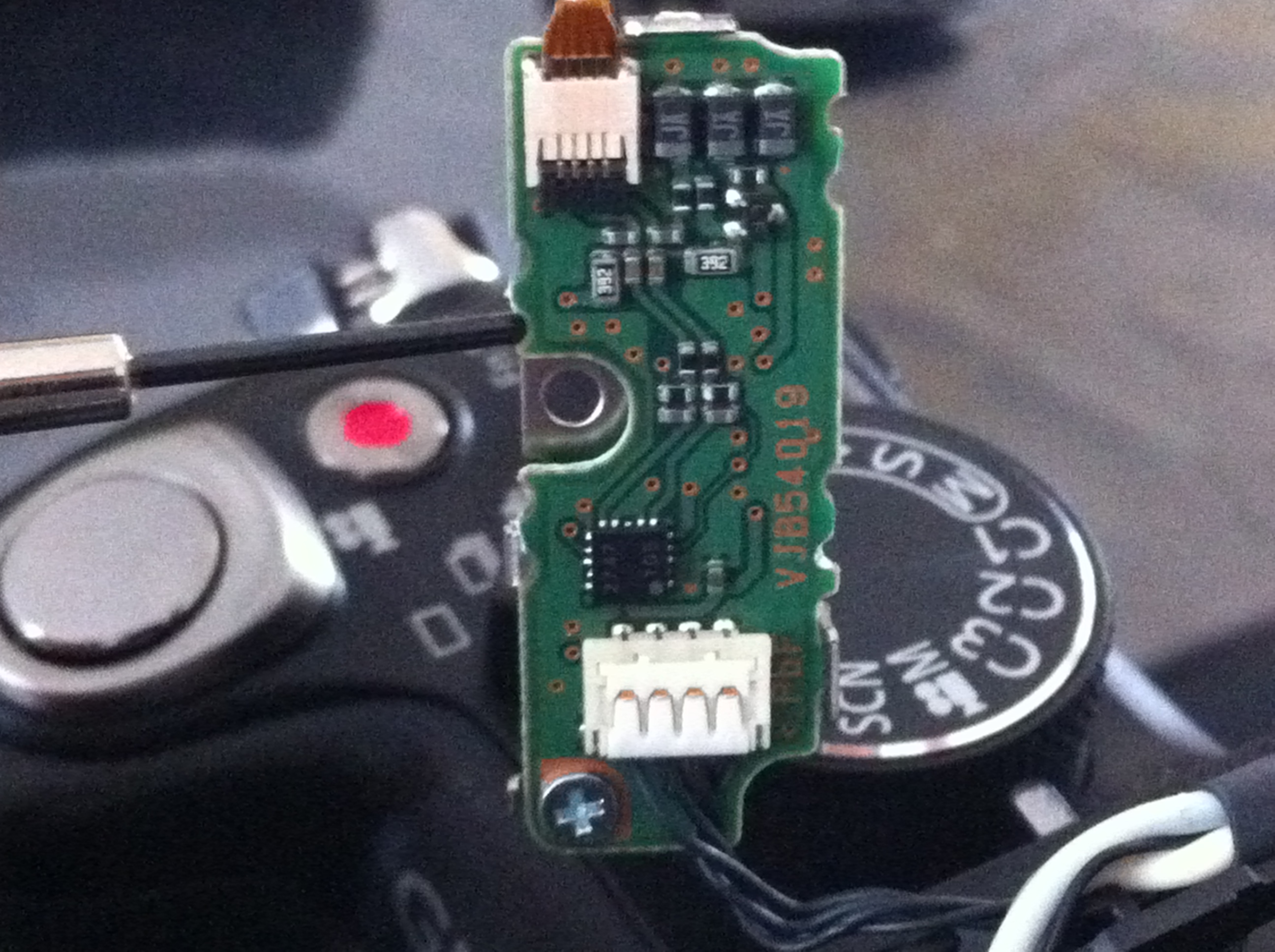

  • Ok so I took the top mic thing off and there is no connection from there to the mini jack on the side - perhaps I was mis reading the link provide here. @Rambo glue sounds good and I do have a right angle mini jack so that might be the best idea. There is quite a gap 3mm + between the camera and the right angle connector but I guess globs of hot glue would work?

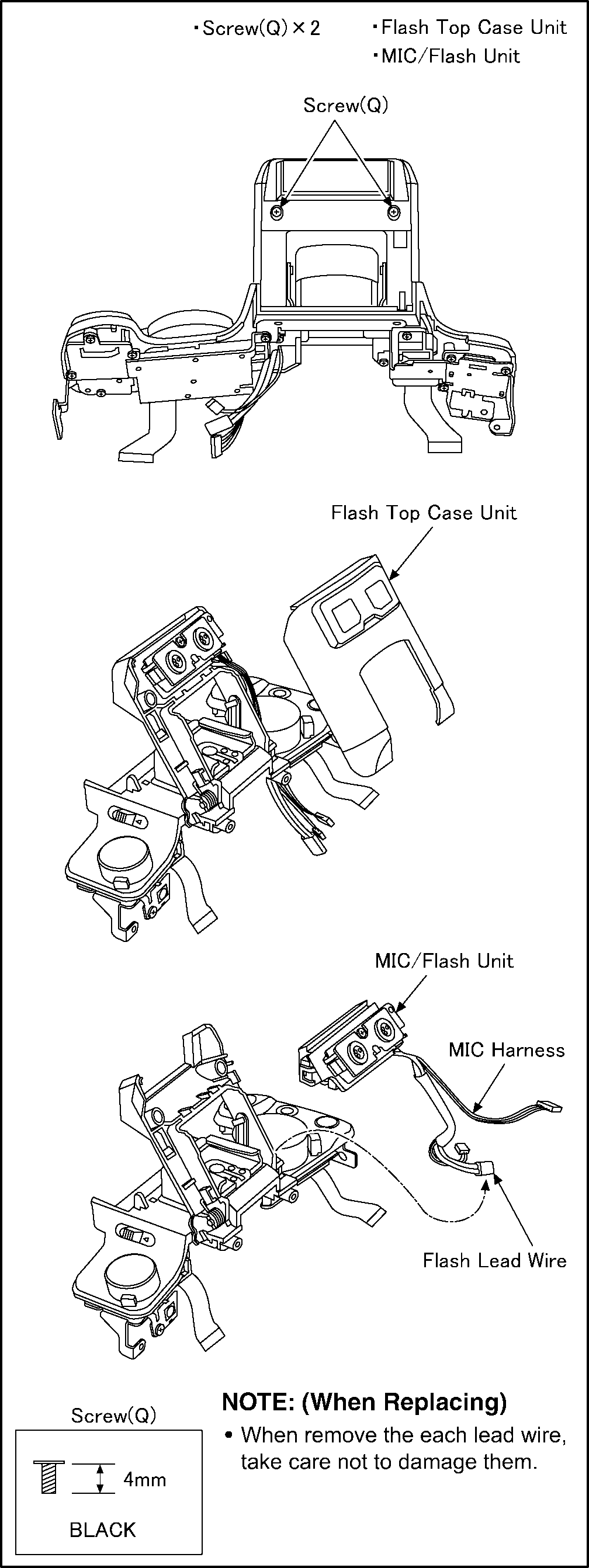

  • How to Discharge the E. Capacitor on Flash P.C.B. CAUTION: 1. Be sure to discharge the E. Capacitor on FLASH P.C.B.. 2. Be careful of the high voltage circuit on FLASH P.C.B. when servicing. [Discharging Procedure] 1. Refer to the disassemble procedure and remove the necessary parts/unit. 2. Put the insulation tube onto the lead part of Resistor (ERG5SJ102:1kΩ /5W). (An equivalent type of resistor may be used.) 3. Put the resistor between both terminals of E. Capacitor on FLASH P.C.B. for approx. 5 seconds. 4. After discharging confirm that the E. Capacitor voltage is lower than 10V using a voltmeter.
    1962 x 828 - 27K
  • Mic PCB Removal image
    1008 x 2685 - 93K
