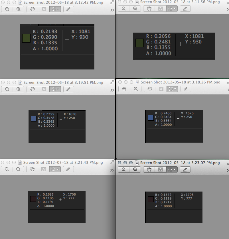

  • So doing conversions with both 601full and 709full - yielded some interesting results. To the eye, the 601 images looked slightly warmer, and slightly brighter.
    Pixel peeping revealed these results. 601 on the left 709 on the right.
    which confirms what my eyes saw which is a weird shift in RGB values that does indeed skew towards a warmer, slightly more green image (as you know luma is tied to green in the RGB universe)

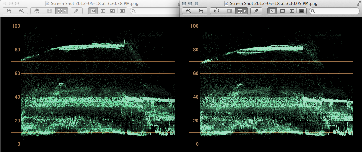

    Waveform monitor shows slightly brighter image. but not lifted from shadows up... just stretched out through mids and highs. BUT the highlights are compressed
    same stretching and compression on broadcast.
