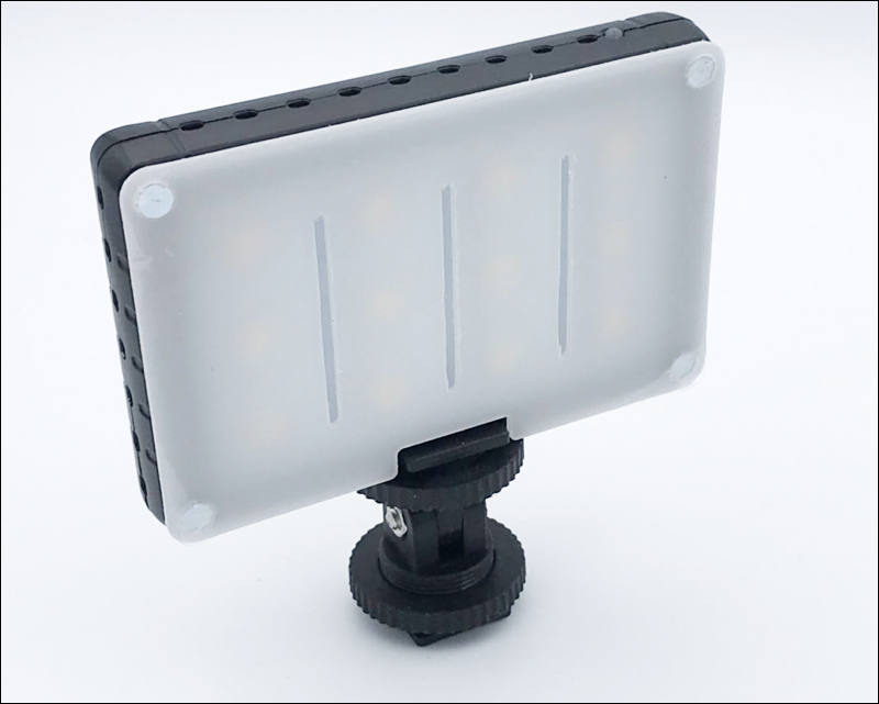

GVB Gear GVBPL12 On Camera LED light ala Aputure M9

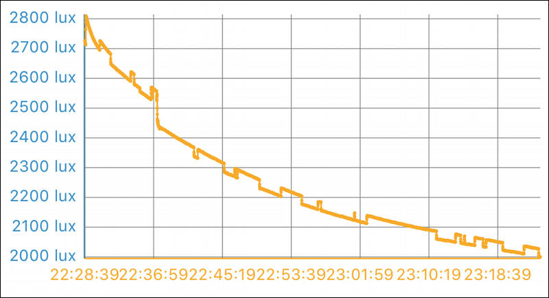

  • We'll do more measurements, but for now controller behavior looks little strange.
    Like M9 it can't keep up output, but it also have sudden jumps.
    800 x 434 - 53K

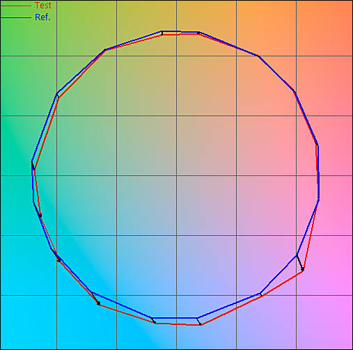

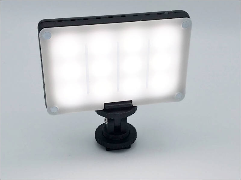

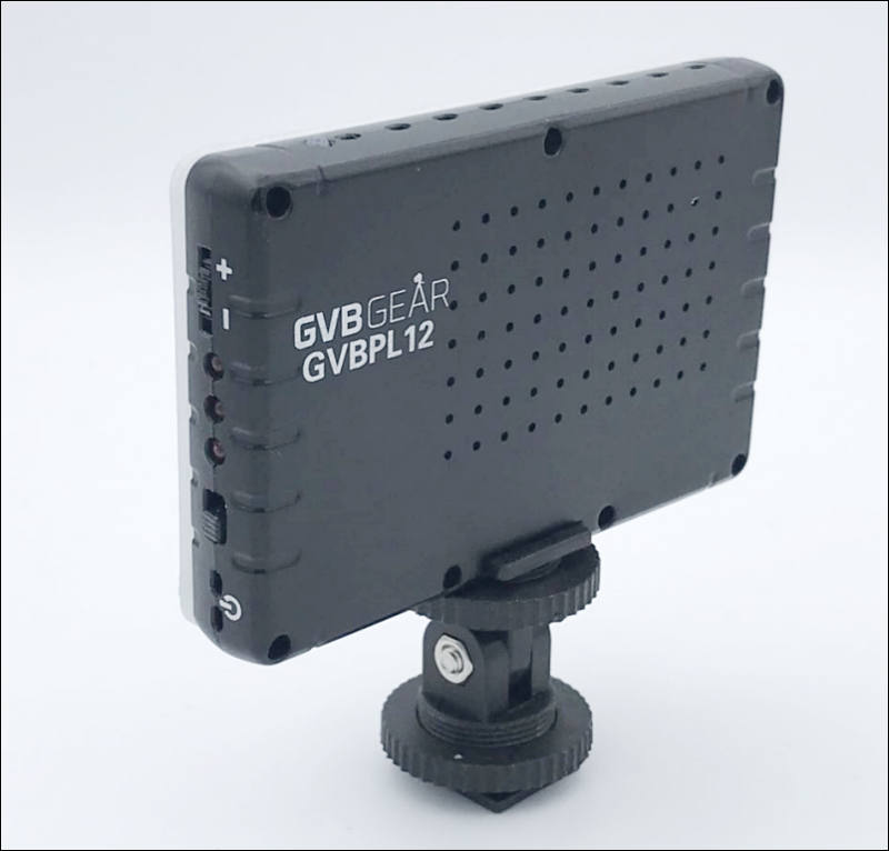

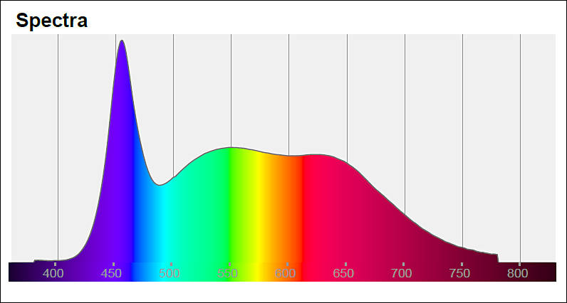

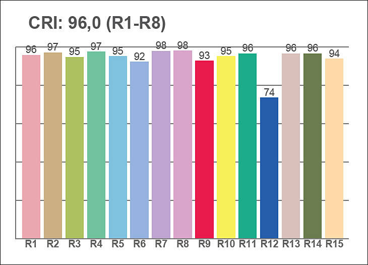

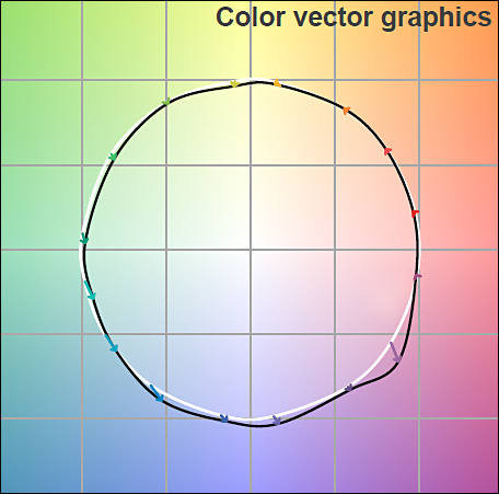

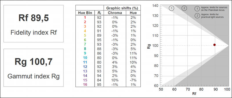

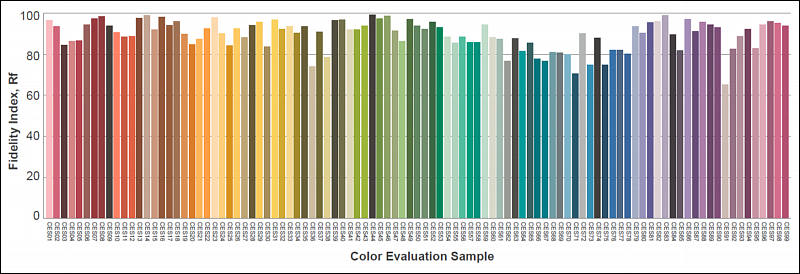

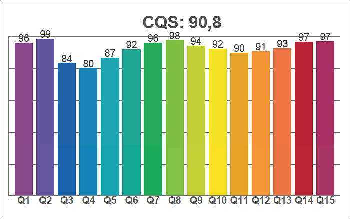

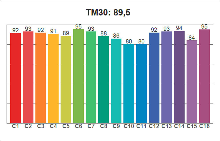

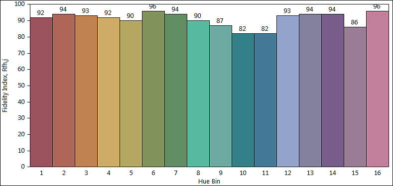

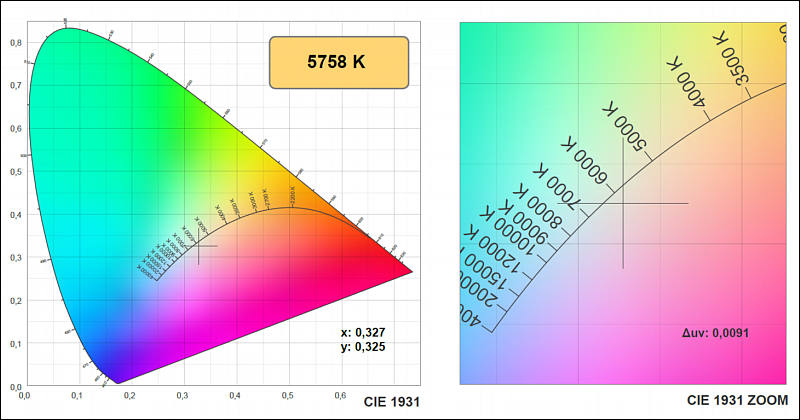

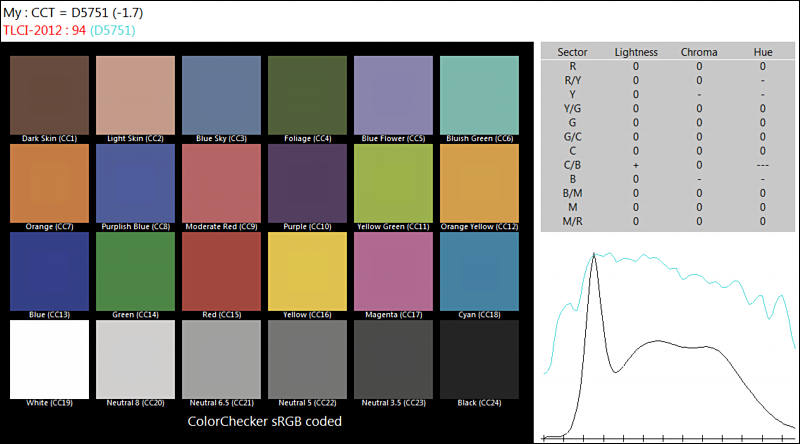

  • GVB Gear GVBPL12 (Daylight model), Measurement using CV600, Russian Lab processing
    Focus on TM30 and CIE 224 and look for color distortion and Rf values.
    GVB Gear GVBPL12 is quite good light with light quality suitable for videos.
    Light tends to be slightly cooler than 5500K.
    Color temperature
    CRI color quality
    CQS color quality
    TLCI 2012
    TM30 color quality
    TM30 details
    CIE 224 2017
    796 x 426 - 35K
    800 x 420 - 57K
    730 x 525 - 54K
    701 x 439 - 53K
    770 x 493 - 62K
    800 x 340 - 44K
    456 x 451 - 31K
    800 x 274 - 68K
    800 x 444 - 48K
    507 x 503 - 48K
    789 x 374 - 43K

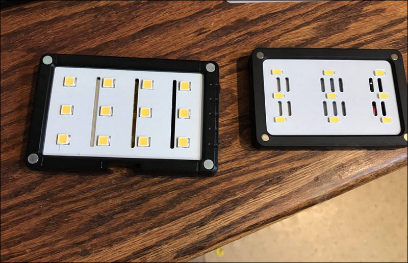

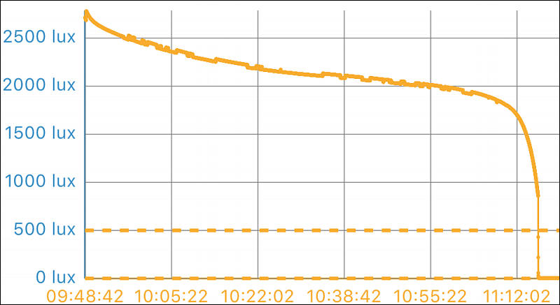

  • More complete brightness during discharge, it is much brighter than Aputure M9
    But same approach used by controller - more life but with cost of falling brightness.
    Compare to M9
    Better brightness due to more and larger leds used
    800 x 437 - 51K
    800 x 516 - 80K

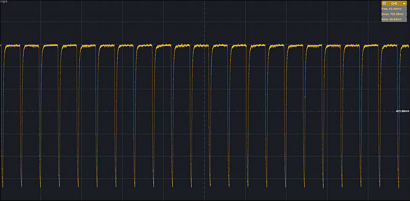

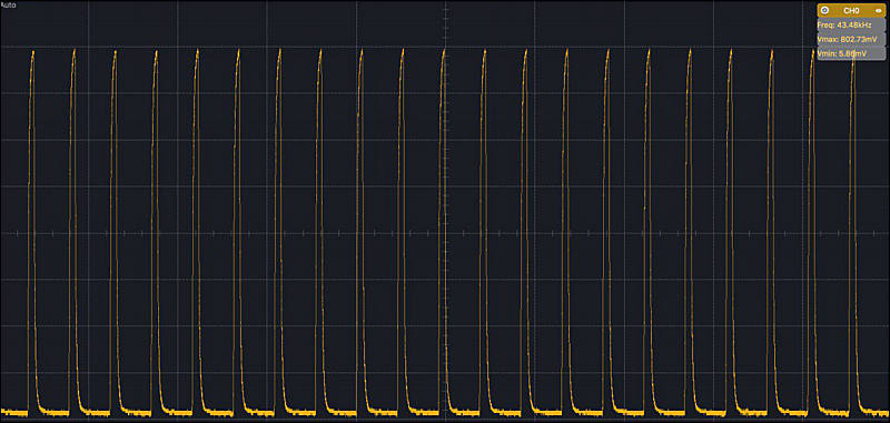

  • GVB PL12 PWM at 100% (battery at not full fresh charge)
    You can see that controller dims leds even at 100%.
    See above that controller can't keep output level.
    PWM Frequency is 43,45Khz
    GVB PL12 PWM at around 25% (battery at not full fresh charge)
    800 x 393 - 47K
    800 x 381 - 57K

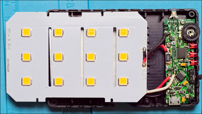

  • GVB PL12 Inside
    Light has simple and cheap design, but better than Aputure M9.
    Wheel used here is much more handy for adjustments and will live longer.
    Front led board has large vertical holes for inside ventilation.

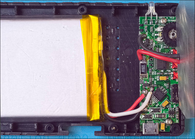

    Battery and strange empty space inside
    manufacturer decided to put empty space with some little vent holes.
    It is not much efficient and take lot of space from battery that could be larger.

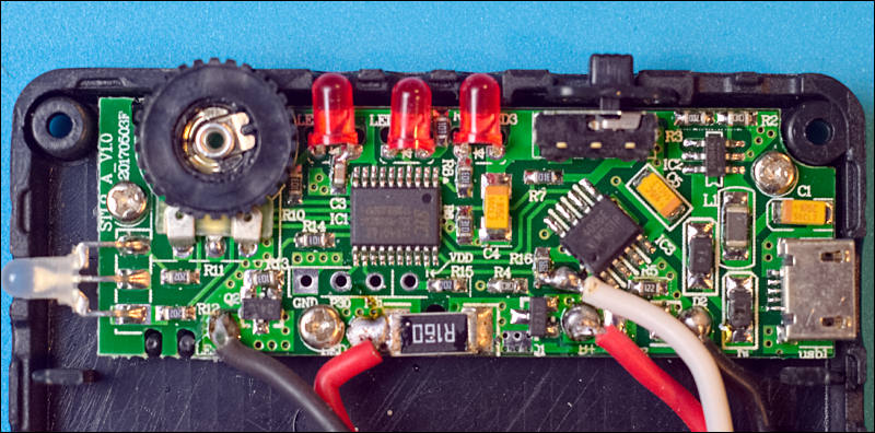

    Main board
    Soldering is not top notch here. Plus board is unnecessary crowded.
    Lot of space is left between board and battery to make proper design and to not have battery wires solder points so densely placed.

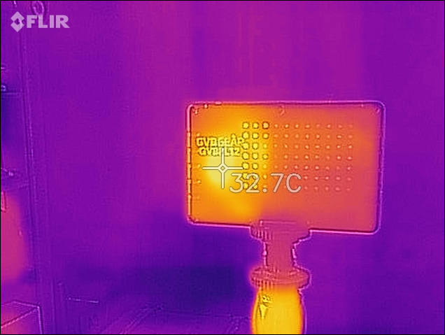

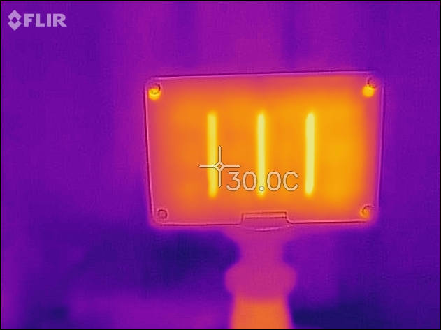

  • GVB PL12 Thermals
    Looks not bad, hottest place is inside main controller board.
