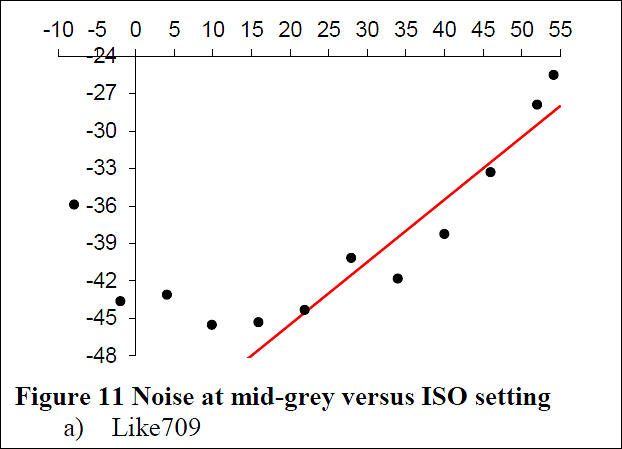

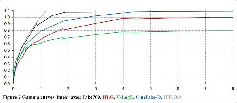

  • For acceptance in the EBU Tiering system, the camera should be used with the optional sound module to allow for XLR audio connections. Monitoring connections are only just adequate, only HDMI is provided, but this connection can carry all the resolutions so this ought not to be a problem.
    Colour performance is good and there was no evidence of any Infra-Red response.
    Resolution at HD is very good, with very little spatial aliasing. At UHD (and therefore at 4K as well) resolution is good but not as good as at HD, and there is inevitable coloured aliasing horizontally and vertically, and diagonal luminance aliasing, but neither is at a high level. This confirms that there is a good optical low-pass filter in the camera, and that the down-scaling to 1920x1080 HD is done with a good algorithm.
    The dynamic range is about 14.6 stops in HLG, a creditable performance. CineLike-D is about 13.9 stops and Like709 about 10.3 stops with the Knee switched off. However, all of this is using the 4:2:2 10-bit recording modes. Using any of the 8-bit recording modes will automatically reduce the dynamic range by at least a stop.
    However, the dynamic range of Like709 can be extended by using the Knee function. Previous tests, not published, showed that the knee can capture about 2.5 times normal exposure (+1.3 stops), so the dynamic range for Like709 can be extended to about 11.6 stops – even with 8-bit recording.
    https://tech.ebu.ch/docs/tech/tech3335_s29.pdf
    800 x 347 - 43K
    622 x 449 - 39K
