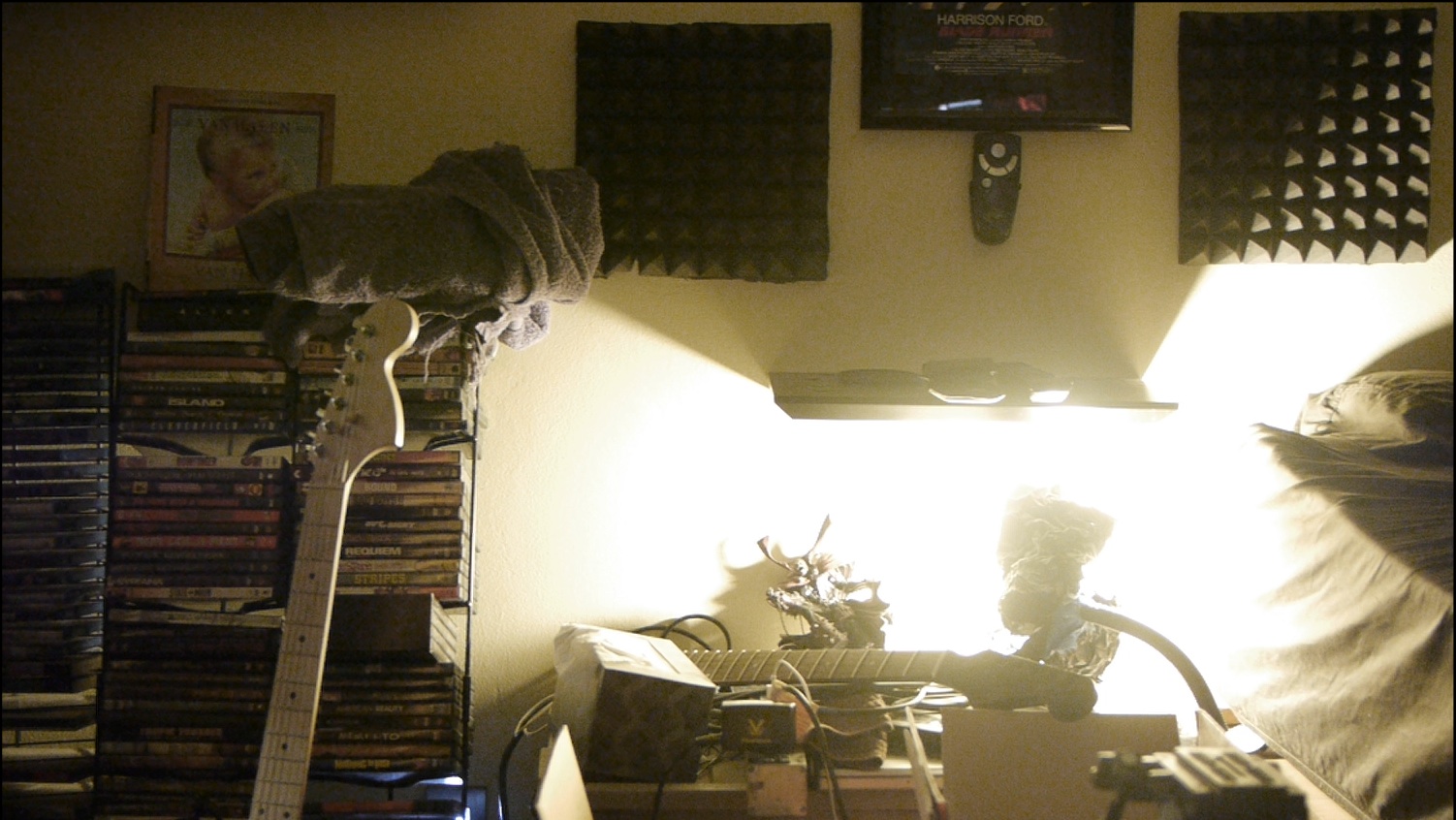

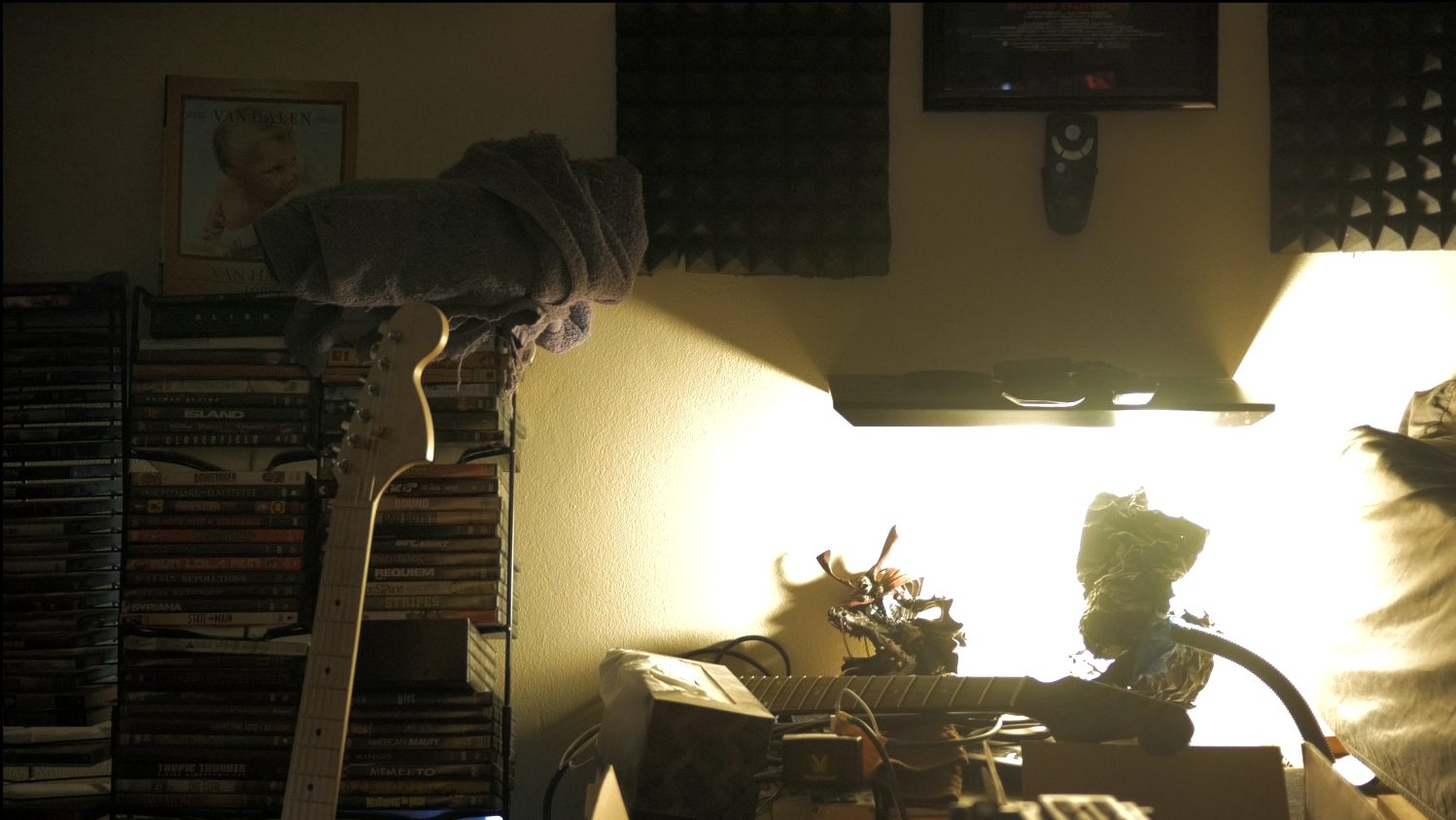

  • I don't have time to export and upload the video, but here's some stills from an extreme high contrast/low light test. The 3rd one is showing the amount of sensor crop there is when shooting 4K...quite a lot. A Speedbooster is likely next on my list of things to buy, cuz wow it crops the hell out of an already cropped lens circle.
    Light Setup - 100 watt CFL light against the wall, and a diffused 100 watt CFL dome light spill from hallway to the left about 17 feet away. Handheld meter reads ambient light in the room at an average of f1.4 (7EV) @1600 ISO. The hotspot on the wall reads 7 stops over. The side of Spawn's cowl where we get detail back is 4.3 stops over. Where the detail on the pale yellow wall starts to pick up detail is 3.3 stops over. The corner of the towel that is edging out of the light and into the shelf shadow is even exposure and the top left corner of frame is 4 stops under.
    If you study the light splash, especially to the left of the image, you'll see where the detail and color starts to return more gradually with the GH4. Also notice the color retention on the towel and the guitar headstock.
    In the GH2 shot, at around the 9th fret or so, the neck on the guitar has a highlight on it , cuz the door was cracked slightly further open so part of the spill from the hall was falling directly on it and bringing up the exposure on that left side of the frame a bit.
    If you discount the hot spot which is blown out, this shot has a DR of around +4 and -4 (9 stops) but 3.3 on top before pale yellow blows out and 4 on the bottom giving us about 9 stops with detail. I'd hesitate to call it 7 usable stop just yet until I do a skin tone test. But I think I'll find 7 usable and 9 with at least a little detail giving us a true 11 stops of DR on the cam. (1 being black, 11 being pure white) Which is what film had up until about 15 years ago when they found ways to expand it. That should be plenty.
    GH2 Intravenus 1600 ISO, 20mm Pancake, f1.7 [smooth -2,-2,-2,-2] image
    GH4 4k downconverted to 1080 1600 ISO, 20mm Pancake, f1.7 [CineD, curves preset 2, pedestal 0, 16-255] image
    crop factor - this is GH2 HD cropped to meet framing of 4k GH4 image
    Much better falloff in the GH4 image in the shadows, the grain even at 1600 is nice and smooth, oh and the detail... you can actually read the titles in my DVD collection with the 4K. Also notice the amount of shadow detail in the light wrap around the shelf and the lamp - considerable improvement there. I can shoot a lot more of the things I like to shoot with this cam, without having to make it work in post... I can get it in cam a lot easier.
    What I did in Post on these: I had to desaturate the GH2 footage to match, cuz it was much more saturated which at this ISO created a bit of color smearing compared to the GH4. Since the GH4 was shot at 16-255, I dropped the black levels down to broadcast to match the GH2, otherwise you'd see a noticeable shadow lift which gives one a false sense of shadow response. I've found that 0-255, 16-235, 16-255 are all kind of nonsense. They don't help your exposure or image quality at all... they only do for you what 5DtoRGB does to MTS files, move the black and white points around, they don't give you any more latitude. To test this; I shot the same thing with all three settings, then moved the appropriate white and black points to match the full 0-255 spectrum... they look identical. Then moved all the white/black points to match 16-235... same thing.

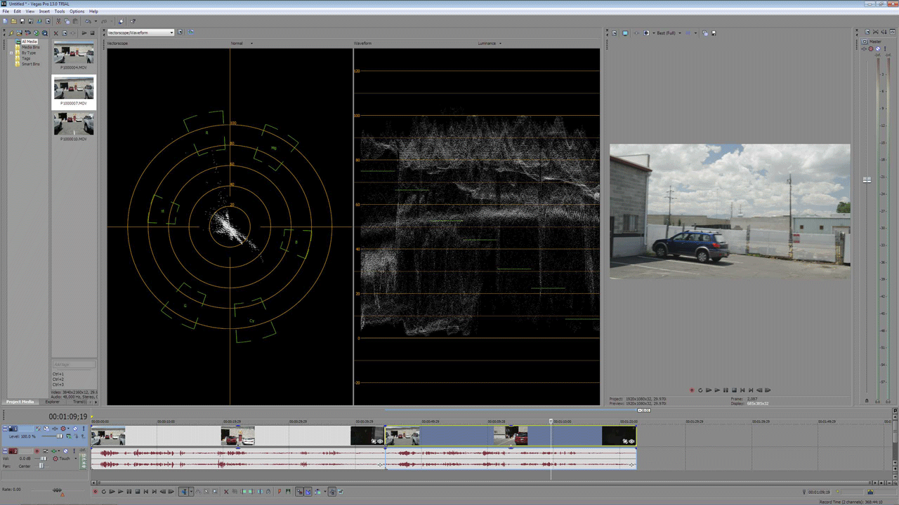

  • @superset, I did some tests with all the different luminance settings and profiles. I'm not exactly sure what the GH4 does differently, but I find the highlight roll off to be smoother and to show less clipping with 16-235 than 0-255.
    here's a gif animation that goes back and forth between the two showing the scopes from Vegas. I believe the scale for Vegas scopes are -20 to +120 IRE. It also doesn't do any adjustments based on the flags in the file. Vegas is a wysiwyg editor, unlike Premiere and FCP that automatically try to display what ever you shot in to 16-235. http://www.c3di.com/c3films/cineV-0_255-vs-16_235.gif
    Anyway, I'm finding my workflow to be easier with 16-235.
    Cheers, Pete
  • @c3hammer
    16-235 doesn't roll off the highlights, it just displays the luminance info differently straight out of the cam. It doesn't add any DR or treat highlights any differently in the recorded image. We all went through this with 5DtoRGB. These settings in the camera are all about what starting point you would like to work with without having to manipulate anything in post.
  • @shian, I have. If you look at the image, you can clearly see that 0-255 clips harder and is much more abrupt at the top of the highlights. 16-235 is a smoother roll off. I know I'm not the best colorist by any means, but I can't get anywhere near as clean an image with that hard clip in 0-255 when adjusting in post.
    I will admit the two scenes are not locked off at exactly the same time, so there may be some differences in the clouds and brightness. Definitely more of the clouds in the 0-255 clip so it's not definitive, but I've seen the effect a number of times with bright daylight scenes.
    Curious to see if others are seeing the same thing in their scopes.
