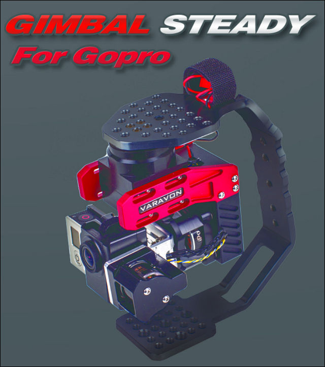

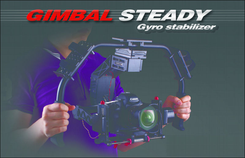

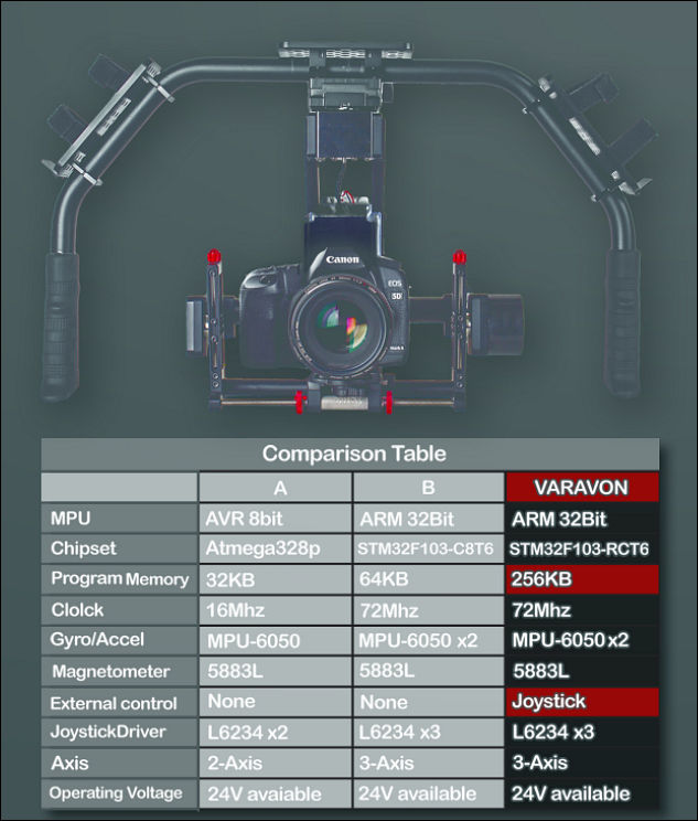

  • Upcoming Varavon gymbals
    800 x 518 - 62K
    633 x 744 - 74K
    640 x 723 - 72K
  • Itll be interesting to see the price on the varavon unit, as they are usually pretty inexpensive.
  • I was skeptical about these things but this past weekend I was at a local camera shop and a customer walked in with the Defy G2 and I got to say, I was impressed from the built quality to the easy of use. It is easy to set up and I can confirm that I didn't notice any sway movement (well I didn't get to use it for long) One of the sales guy at the shop who is also a cinematographer did mentioned to be careful to by from a manufacturer that's dedicated in making 3-axis stabilizers like MOVi or Defy. I kinda told myself, I was gonna spend +$3000 on a stabilizer, I will buy a Defy. I doubt the varavon system is gonna be cheaper.
  • Be careful to by from a manufacturer that's dedicated in making 3-axis stabilizers like MOVi or Defy. I kinda told myself, I was gonna spend +$3000 on a stabilizer, I will buy a Defy. I doubt the varavon system is gonna be cheaper.
    This market will change in upcomign year very significantly. With mentioned manufacturers pushed into niche top market. As for varavon stuff, don't make assumptions :-)
