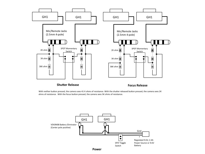

  • I've attached a simple diagram here that shows a basic, mechanically switched sync "controller". This device DOES work well with GH1s and manual lenses, but, may not be the ideal solution. One of its biggest faults is that the manual switches may "bounce" when closed which can cause sync problems. It does work for me. Your milage may vary! Builder beware!
    Usage is simple:
    1) turn GH1s on (with controller power off)
    2) switch controller power on
    3) press "shutter release" - cameras will begin recording
    4) at end of take, press "shutter release" to stop recording
    5) power both cameras off using the GH1 power switches (not the controller power)
    720 x 540 - 53K

  • To be clear, all the detection is done on the remote->ground lines:
    open = nothing connected
    zero resistance = mic connected.
    41k resistance = remote is connected
    5k resistance = remote half-shutter
    2k resistance = remote full shutter
  • The body most likely measures voltage, so in voltage terms:
    ~3V: mic connected
    ~2.5V: remote is connected
    ~1V: remote half-shutter
    ~ 0.5V: remote full shutter
