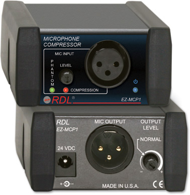

  • @Rambo The attack and release (basically how fast it reacts to loud sound and then how fast it goes back to normal when things get quiet) are probably optimised for speech. I guess it might be ok for speech applications but if it is, it will probably do horrible things to music. But as @duch says, depends what you want to use it for. It will never replace being careful with audio levels but could be useful in extremely uncontrolled situations where you'd otherwise get distortion.
  • Yes i'm in uncontrolled live situations outdoor usually near or on the ocean. Voice capture only and cannot use a sound person, so no one to ride gain/levels etc. I use a Senny K6 mounted up or down on a tripod as close as possible to the voice without being in the frame. Yes i use lavs as well. I figured it may be better than the compressor/limiter in the Zoom h4n and also act as preamp.
