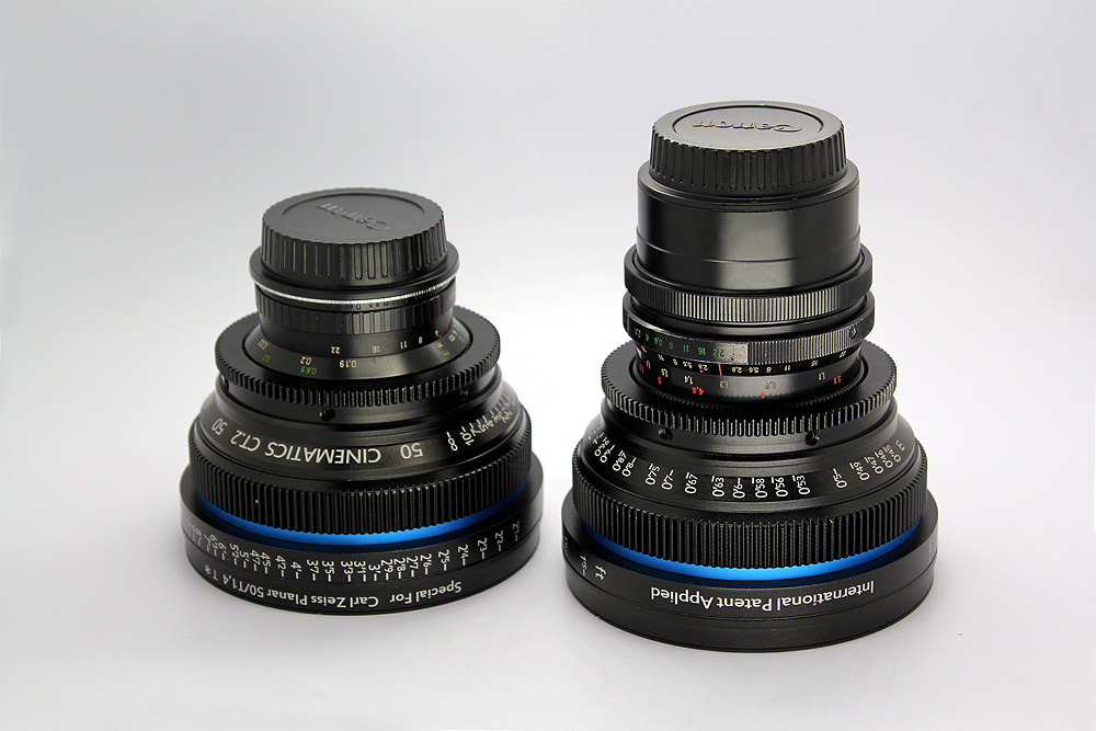

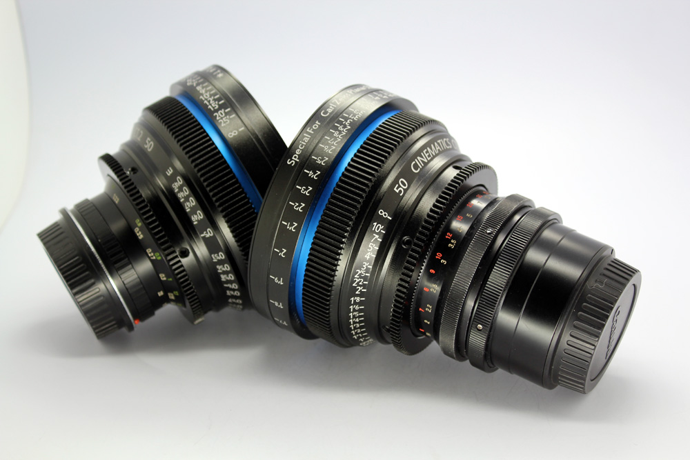

  • Where to buy those Cinematics CT.2?

  • @Vitaliy_Kiselev
    Ah, I see: "Cinematics CT.2". Very nice work.
  • @LPowell
    >Thanks for posting the detailed images of the Zeiss CP.2 prime lenses
    This is not Zeiss CP.2 if you look carefully :-)
    This is special housings and conversion done by Cinematics, much cheaper than original CP.2.

    Contax Zeiss primes are superb still photography lenses, but as with Nikon AI-S, Canon FD, Pentax K, Minolta MD, and Konica AR primes, they are not really well-suited for use on a rig with follow focus and matte box. Image quality is not the issue here, it's primarily a matter of ergonomics, with cost a secondary factor. The lenses I listed above are all available new or used for less than $500.
    @Vitaliy_Kiselev
    Thanks for posting the detailed images of the Zeiss CP.2 prime lenses. These are designed explicitly for video use and are ideal examples of the type of ergonomics that's required. They currently retail for bit less than $4000 each.
