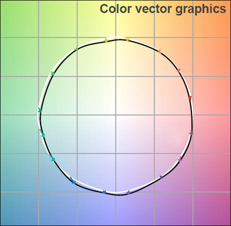

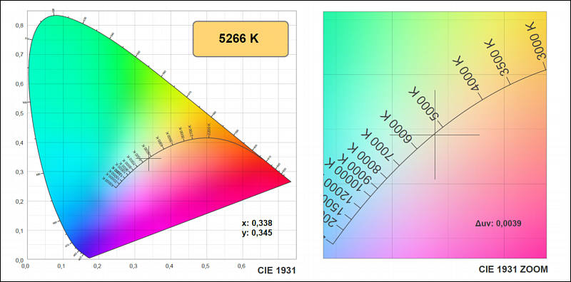

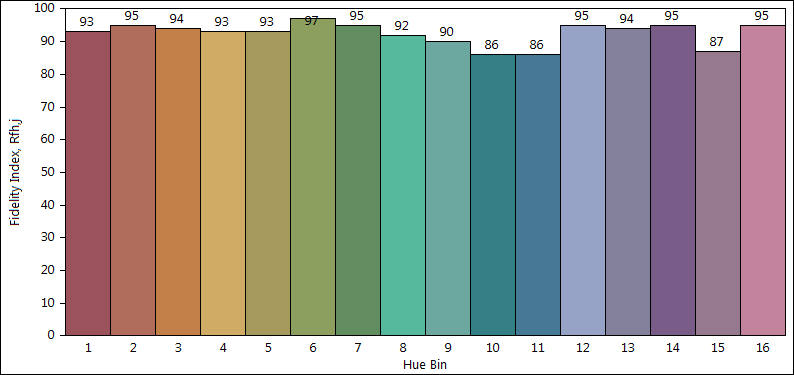

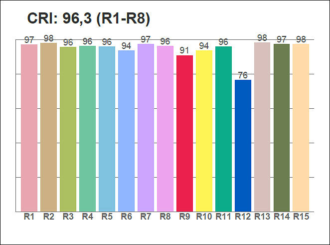

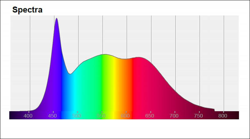

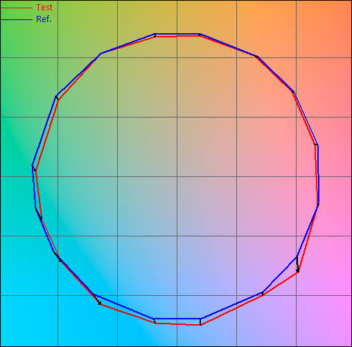

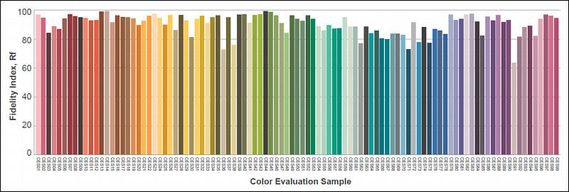

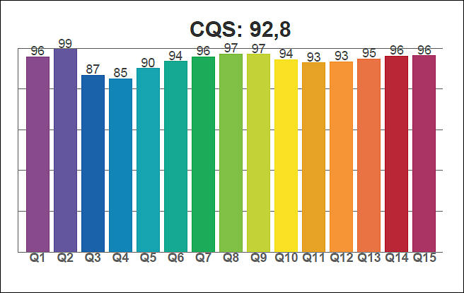

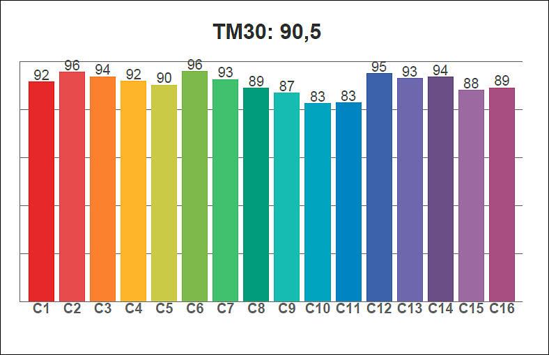

  • Aputure 300d (daylight version), measurement using Lisun, Russian Lab processing
    Focus on TM30 and CIE 244 and look for color distortion and Rf values.
    Aputure 300d is good light with proper color temperature, light quality is very good and suitable for videos.
    Color temperature
    CRI color quality
    CQS color quality
    TLCI 2012
    TM30 color quality
    TM30 details
    CIE 244 2017 (Rf = 92)
