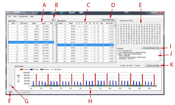

The StreamParser Frames Mode window consists of several components:
  • A. Stream Data panel. This breaks a stream down into frames. The first column shows frame number in display order. The GOP.Frame column shows the frame number in GOP.Frame format. Offset is the starting address of the frame in the MTS file. Length is the amount of data in the frame. Type indicates frame type (I, P, B, or A). Audio (A) frames are only shown if the “Include Audio” checkbox above the Stream Frames graph has been checked. Clicking on column headers will cause data to be sorted according to the selected column.
  • B. Sel. Pressing this synchronizes the Frame Data Panel with the Stream Frames graph. The first frame in the Stream Data Panel is set to the first frame shown in the Stream Frames graph.
  • C. Frame Data panel. This breaks down a frame selected in the Stream Data panel into Transport Stream (TS) packets. The first column shows the packet number relative to the beginning of the selected frame. Offset is the starting address of the packet in the MTS file. E, S, and P are TS header flags. PID is the TS Packet ID. SC, AF, and CC are TS header flags. Type is the packet type – “V” for video and “A” for audio. Abs Packet is the absolute packet number (i.e. relative to the beginning of the file). The number next to “Frame Data” is the frame number selected. Clicking on column headers will cause data to be sorted according to the selected column.
  • D. Pressing this will start up the media player. The media player is explained in more detail below.
  • E. Packet Data. This shows hex data for a packet selected in the Frame Data panel. The numbers next to “Packet Data” are Packet/Abs Packet number for the selected packet.
  • F. Similar to item C, above; except the first column in the Stream Frames graph is set to the selected frame in the Stream Data panel.
  • G. This slider determines how many columns are displayed in the Stream Frames graph; it is used to zoom the graph in or out.
  • H. The Stream Frames graph. Depending on which “Include” checkboxes are selected video, audio, or both frame types are plotted. The graph can be set to display frame size in bytes or bits.
  • I. Displays the contents of the Information panel (J) in a bigger window.
  • J. Information panel. This contains information about the Stream, the selected frame and packet.
  • K. This puts StreamParser into Time mode.
