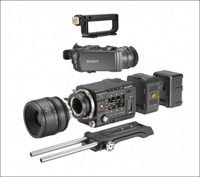

    Sony is unveiling two new CineAlta™ 4K cameras, complemented by a full line-up of new accessories. The new cameras, the PMW-F55 and PMW-F5, fill a critical gap in large-sensor acquisition between Sony's PMW-F3 camcorder and its F65 CineAlta Premium 4K camera, giving content creators new levels of flexibility and creative options for HD, 2K or 4K acquisition and production.
    With a modular and compact design for easy configuration, each camera features a new type of 4K Super 35mm image sensor with a 4096 x 2160 resolution (11.6M total pixels).
    The 20 megapixel F65 remains the flagship of Sony's large sensor camera family. The 8K sensor-equipped F65 continues to evolve, with new features designed for the most demanding high-end imaging applications. These features include a new high frame rate mode for 4K RAW recording at 120P to deliver stunning 4K images with super smooth slow motion capabilities, and image capture using the SR codec at 12-bits. Future updates to the F65 will deliver 6K de-mosaicing, along with other major new features.

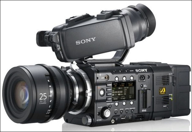

    New PMW-F55 and PMW-F5 Cameras
    The new PMW-F55 and PMW-F5 CineAlta 4K cameras deliver unprecedented creative options for HD/2K/QFHD/4K (PMW-F55) and 2K*/HD (PMW-F5) production. Both offer multi-codec support featuring Sony's new XAVC MPEG-4 AVC/H.264 format, the SR codec (MPEG4 SStP) and the industry-standard High Definition XDCAM 50Mbps 4:2:2 codec. In-camera recording is on Sony's New SxS media, SxS PRO+ (Plus ) – which can be used to record XAVC in HD High Frame Rate and in 4K at up to 60fps (in the PMW-F55), and XAVC HD High Frame Rate in the PMW-F5.
    In addition to on-board recording onto SxS PRO+, the PMW-F55 and PMW- F5 can also be connected to the new AXS-R5 RAW recorder. Slow-motion imagery at up to 240fps** (PMW- F55) and up to 120fps** (PMW- F5) can be captured as 4K RAW files on newly developed AXS memory.
    The PMW-F55 features a global shutter to eliminate rolling shutter skew and flash band, and features a wider colour gamut for exceptional colour reproduction. The cameras are further distinguished by wide (14 stops) exposure latitude, high sensitivity, and low noise.
    New Options for Monitoring
    The PMW-F55 can connect to the new 4K 30-inch LCD monitor, PVM-X300, using four 3G-SDI interfaces to monitor pictures at 4096x2160 resolution at up to 60p, while recording and playing back XAVC 4K images. Similarly, it is also possible to connect directly to the 84" BRAVIA 4K LED TV for large-screen monitoring of the camera's 4K 60P images (at resized horizontal resolution of 3860 pixels).
    PL Lens System – The Second Generation
    The PMW-F55 and PMW-F5 cameras continue Sony's efforts to offer the most flexible lens options. A PL-mount lets users choose cinematic lenses from suppliers such as Angénieux, ARRI, Canon, Carl Zeiss, Cooke, FUJIFILM and Leica.
    Sony is also launching a second generation of cost-effective PL mount prime lenses. Each is certified for 4K capture, and is designed to minimize geometric distortion, vignetting and breathing. A 9-blade iris delivers beautiful bokehs and the focus rings rotate 240°. The new lens series includes focal lengths of 20, 25, 35, 50, 85 and 135 mm. For easy lens changes, each has the same T2.0 aperture, the same external diameter, matte box diameter, and gear locations for follow focus and aperture. All are the same height except for the 135 mm lens.
    Shooters can use stills lenses by removing the supplied PL-mount adaptor to reveal the native FZ mount. This makes it easy to accept commercially available adaptors for third-party lenses, including Canon® EF, Canon FD, Nikon® DX, Nikon G, Leica® M and even 2/3-inch B4 lenses. A third option is the use of Sony FZ-Mount lenses with auto focus servo zoom (model SCL-Z18X140.)
    Viewfinders
    Using a new digital interface, PMW-F5 and PMW-F55 users can take advantage of a new series of high-quality OLED and LCD viewfinders. The DVF-EL100 OLED viewfinder measures 0.7-inches with 1280 x 720 HD resolution, superb brightness, contrast and response. The DVF-L350 3.5-inch LCD viewfinder offers 10 times the contrast of previous Sony LCD viewfinders, with a flip-up eyepiece for direct monitoring. A third option is the full HD DVF-L700. This compact 7-inch LCD viewfinder enables high resolution when shooting in 2K and 4K, with pixel-to-pixel 1920 x 1080 representation of HD images.
    New RAW Recording System
    Sony is also unveiling the AXSM™ Access Memory System for 2K*/4K RAW recording, based on Sony's unique recording technology. Optimised for this new platform is the AXSM memory card (512 GB capacity, model AXS-512S24), using the generic file system exFAT. Users can record 4K RAW data up to 60 fps and 2K RAW up to 240 fps**, with a 300MB/s sustained transfer speed. PC-friendly operation is enabled through use of the AXS-CR1 card reader, offering a USB 3.0 interface for high speed transfer.
    Additionally, the new AXS-R5 RAW recorder directly docks onto the PMW-F5 and PMW-F55, for an extremely elegant and compact recording system for 2K** and 4K RAW recording.

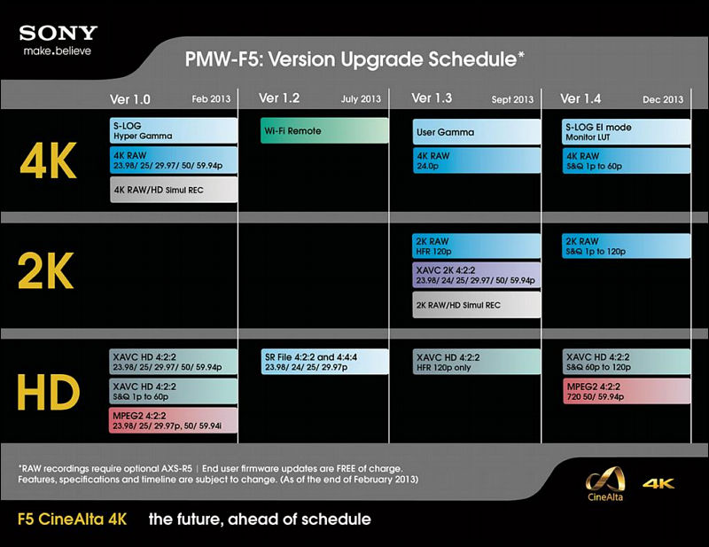

  • After extensive input from all of you, we present to you the ongoing development and new firmware timeline charts for the AXS-R5, F5 and F55. .
    Highlighting the big update this month is the HD – 10 bit SR Codec, (SR File). This codec has been strongly requested for episodic television and feature film work; since it’s an extremely robust algorithm that is visually lossless (areas of every frame are uncompressed). Also, 220Mbps 4:2:2 and 440Mbps (both 4:2:2 and RGB) result in very manageable file sizes and very easy to decode.
    The SR File is the exact same codec as used in the HDCAM-SR digital tape system, which was, and in many cases still is, the mastering and deliverable standard in the production industry. For shooting in HD, the picture quality of SR File with the F5 and F55 should prove spectacular and will be a key differentiation from every other camera on the market today for HD production.
    You may also notice on the charts that, where possible, the F5 is updated with the same features as the F55. Some major changes to the firmware timeline include the support of exposure tools, (more are coming in addition to what is listed in the charts), and the addition of 1.3 x Anamorphic. False Color is confirmed but exact implementation is being finalized and will be announced soon.
    After significant feedback about the F5 high frame rate, we studied the possibility of increasing HFR to the same level as that of the F55, which is up to 240 frames per second. As a result of this effort we are proud to implement 240fps in the F5 in a future firmware update.
    2K RAW: September will see the same frame rate values being implemented as the F55 which are 120P, 180P, and 240P.
    XAVC HD: Both cameras will have 120P HFR
    Later we will implement the Slow/Quick mode, meaning each frame can be individually dialed in, up to 240fps speed. (Refer to the charts below for more information)
    ND filter knob – We are going to provide an upgraded filter knob for FREE later this month. Details will follow.
    New Cables – For purchase, new cables connecting the DVF-EL100 OLED VF to the camera body will be available, expected later in July.
    B4 2/3″ lens adapter is confirmed, details will be posted here when available
    Please keep in mind that all features are always subject to change, and not every feature is listed in these charts as some are still going through engineering analysis in terms of when and how they can be implemented.
    So if you do not see your desired feature listed, don’t be discouraged. It does not mean that it’s not coming.
