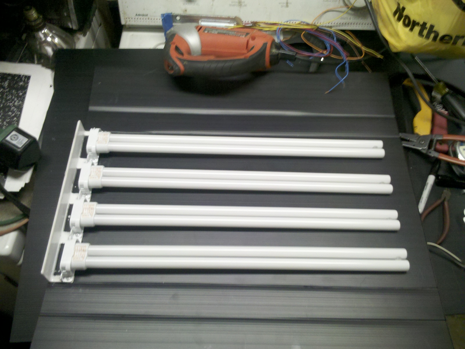

  • I'm working on a DIY version of the Kino Diva type lights. I used some a couple weeks ago and found them to be very useful for a number of situations but they are way too expensive for how they are made. So far, I've built a working prototype for 1/5th the price but still have a long way to go to make it robust.
    Corrugated plastic sheet 5$ Sockets and mounting parts 25$ Metal for mounting sockets and support 10$ Kino bulbs 80$ 2x dimming ballasts(two lights per) 100$
    I will need to build a cover for the ballasts and then a mount for the light stand, I'll cover that as I go along.

  • Sure, the knock-offs would work fine, but I'm using good bulbs that don't need gelling and I'm using true dimming ballasts just like the Kino brand. Those two add significant cost to the DIY but I find are priceless in actual usage. I messed around with a cheap 4 bulb ballast that had the ability to turn off 2 of the bulbs, and it worked fine, but i kept finding myself spending ages trying to dial in the amount of light with ND gels, scrims or other things either from the flo or from the other lights to make them right. With the dimming ballasts, you just turn a knob until your light meter says it's good or it looks right in camera.
  • Kino Diva bulbs always need gelling regardless if it's Kino brand or not. They have a slightly Magenta light to them. My experience is you always need to add 1/4 green gels regardless of brand. Cool Lights has some good quality stuff. This is where I got a couple of my Kino like fixtures.
