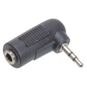

  • @peaceonearth I use this one without any trouble
    250 x 167 - 47K

  • Ive been using the right angled one that tinbeo posted, only I got mime from B&H for about $4, so picked up a couple. Have used it many times with good results and didnt have to shave any material.
