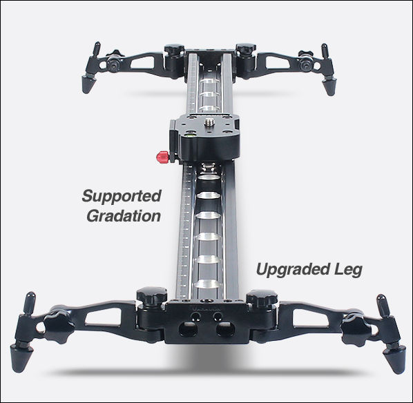

  • I purchased a Varavon S here, and so far I'm very happy with it but I noticed a problem with the legs which appears to me as a big design flaw: basically, for each pair of legs, it's impossible to set the left and right legs at the same level, because the dents, because of the way they are conceived and mounted, can't correspond (see in images 1 and 2 that the left leg can be set only higher or lower than the right leg). Only solution seems to be assembling the feet like I did in image 3, but that doesn't look a perfect solution. Am I missing something?

  • @flablo
    May be just one leg adjustment is too small so it bumps.
  • @Vitaliy_Kiselev both pair of legs have this problem. Right and left legs just can't be set at the same level. I suspect they made an error with assembling my unit: all the components of the 4 legs are identical i.e. there's no right/left version of the legs but they are assembled as if they are (hence my third picture). Also I realized they gave me the old version of the legs, even if I bought it just 3 months ago... EDIT sorry maybe I'm wrong, these are new version, the older where made of just one piece(?)
  • @flabo I have the exact same issue with mine, its a design flaw for sure
  • @flablo
    Got it. As you can see on picture it is not so.
    Btw try to check all 4 legs, may be it'll be possible to change one from each two to make them perfect.
  • @Vitaliy_Kiselev I did and it's not possible, except in the configuration I tried in the third photo. Basically, I have 4 left-legs and 2 of them have been assembled as if they were right-legs. I found pictures online of how the legs should really be (see image attached). Maybe I could ask them to send me only the missing/wrong little parts to replace
