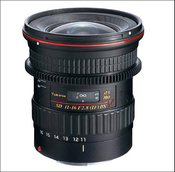

11mm - 16mm F2.8 Tokina
    I'm buying the Tokina 11mm - 16mm f/2.8 with the Nikon mount to use it with the GH2 and after July with the BMC for the GH2.
    Would it be any pros and cons buying the Canon mount EF instead, which will be mount native for the BMC?
    Thanks in advance.
