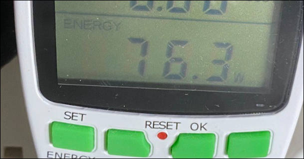

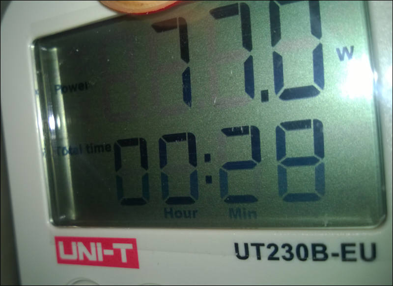

    • 60W real light power, 78W consumption (ignore that it is declared as 100W consumption panel)

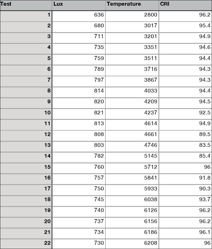

  • Measurements
    Lux measurement here is center of light spot at 1 meter.
    744 x 875 - 87K
  • Consumption (two different panels)

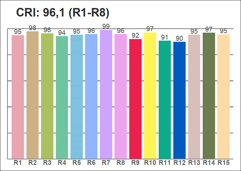

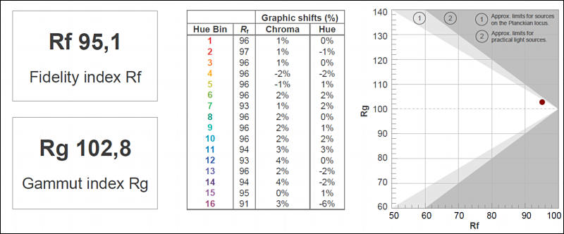

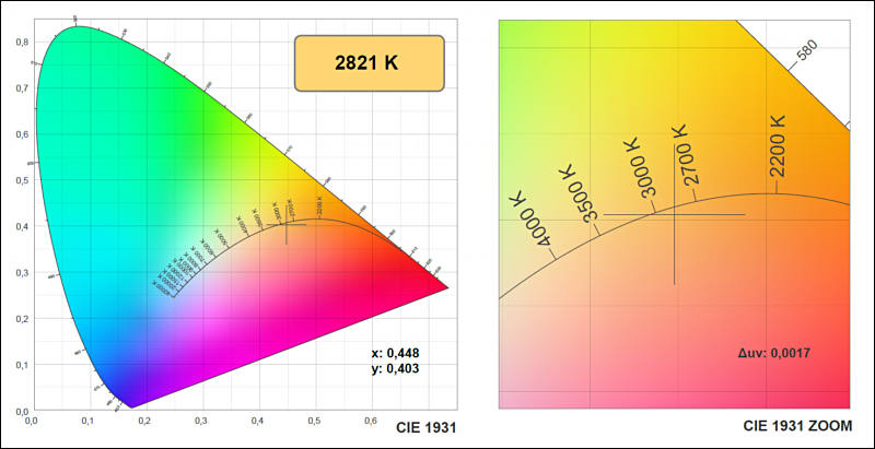

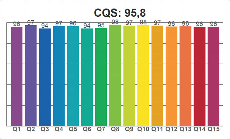

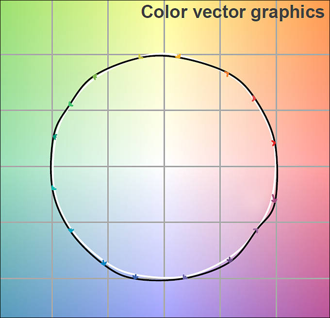

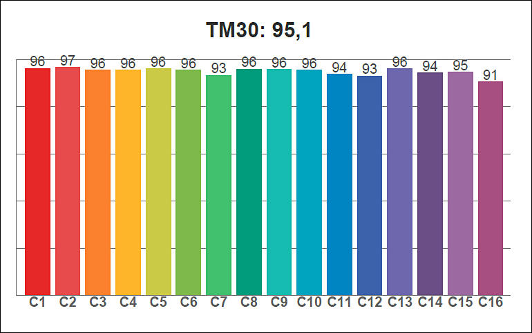

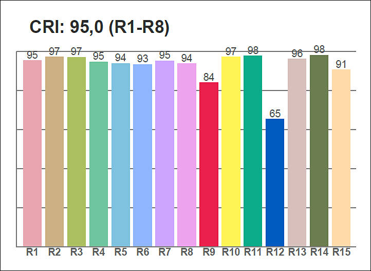

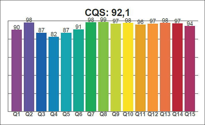

  • Warm end spectrum and light quality (2800K), is very good for such price light:
    800 x 425 - 33K
    800 x 411 - 50K
    800 x 566 - 65K
    800 x 484 - 62K
    770 x 483 - 63K
    800 x 332 - 45K
    680 x 656 - 54K

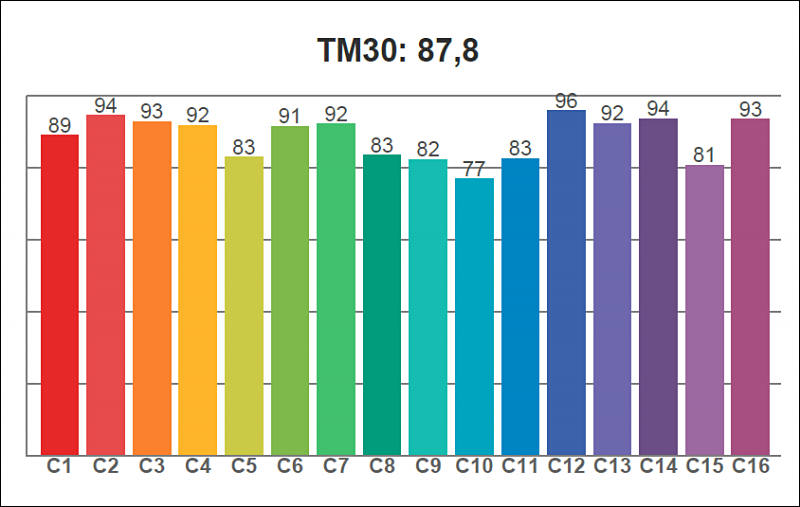

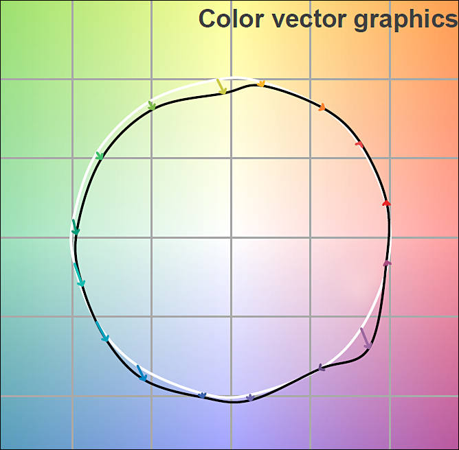

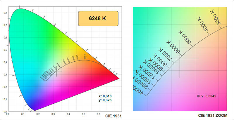

  • Cold end spectrum and light quality (6250K), is typical for high CRI blu led based light:
    800 x 478 - 33K
    800 x 411 - 56K
    722 x 527 - 63K
    714 x 438 - 57K
    800 x 507 - 66K
    668 x 656 - 54K
