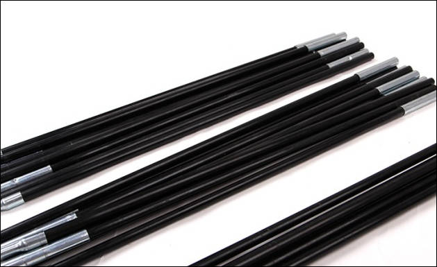

  • @joethepro
    Try to look for rods used for tourist tents
    629 x 385 - 36K
