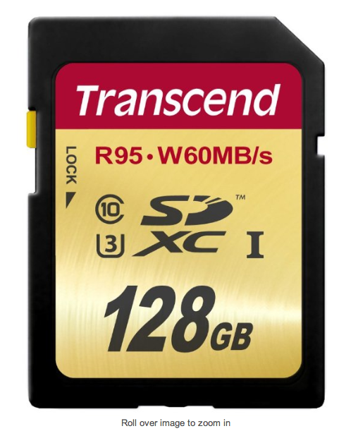

    I had formatted the card in the camera before the shoot and it was my trusted GH4 128MB Transcend card (see pic below) Turning the camera off, did no good. Camera was frozen. Had to pull the battery and the camera left me a zero byte .mdt file. where there should be a file full of data.

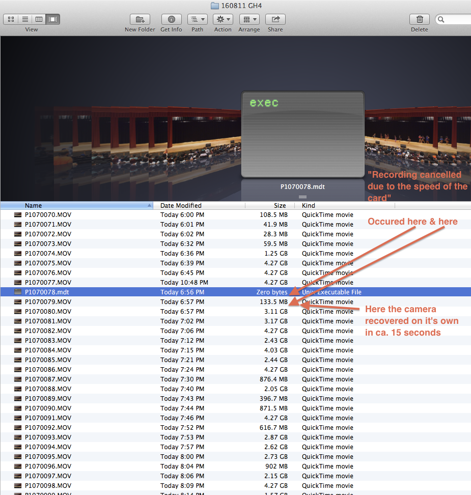

    "Recoding cancelled due to the speed of the card" occurred again almost immediately after restarting the camera and hitting the record button, the camera did recover in about 15 seconds, that file did get written out (see screenshot). I suspect I got the zero byte .mdt file from the 1st failure because I pulled the battery before the camera finished writing the file, but, unfortunately it appeared that the camera was frozen. While missing part of a live event every second counts and I didn't think the camera was going to recover (from my GH1 hacking experiences).
    I was able to record the rest of the show, but, I made sure that I stopped the recording for the brief pauses between performances. Some of those files did span to a second file and recording was not interrupted.
    Upon inspecting the files afterwards on the card, it seems that the failure while filming the kids in sequined costumes occurred, as the camera was spanning or had just spanned to a new file and was perhaps writing out the end of the previous file.

    Am I using a card that is not approved for the GH4? If so, what SD card would you recommend?
