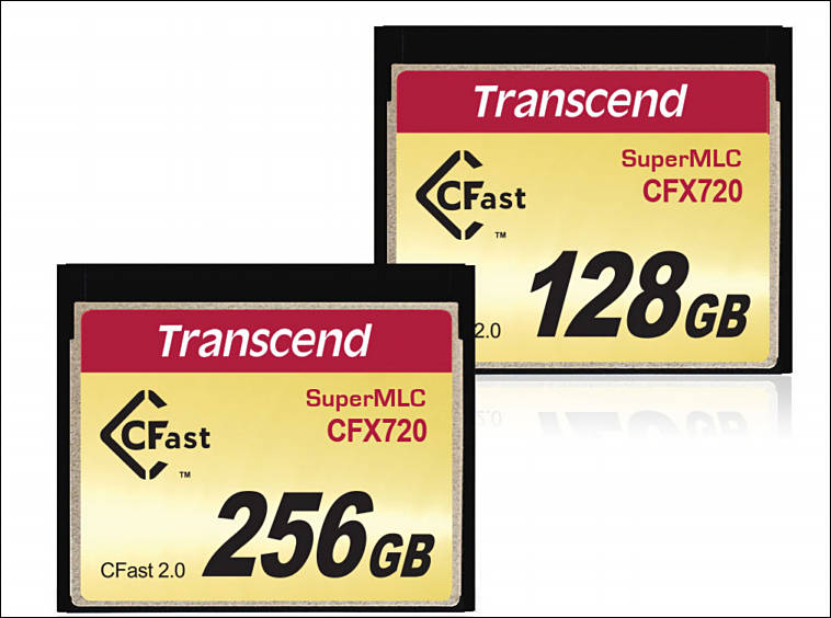

  • With the rapid development in cinematography, the audience has also increased their demand for image quality. Transcend Information, Inc. (Transcend), a worldwide leader in storage and multimedia products, is proud to announce the launch of its CFast 2.0 CFX650 and CFX600 Memory Cards. Designed to support high-end 4K cameras and camcorders from the leading manufacturers and to meet the extreme demands of professional cinematography, Transcend’s CFX650 memory cards feature the fastest transfer speeds available on the current market, while CFX600 boast the highest storage capacity. Both cards are best suited for the professional cinematographers shooting high-resolution 4K and Full HD videos.
    Transcend's CFast 2.0 CFX650 memory cards are available in 128GB($499) and 256GB($949), while the CFX600 cards are available in 128GB($249), 256GB($499) and 512GB($949) capacities. All Transcend CFast 2.0 cards are comprehensively tested for speed and reliability, and are backed by Transcend's Three-year Limited Warranty.

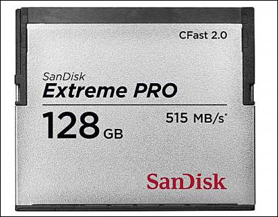

    Sandisk unveiled significant upgrades to its SanDisk Extreme PRO CFast 2.0 memory card and announced that the SanDisk Extreme PRO SSD has been qualified for 4K capture. These two products expand SanDisk’s extensive portfolio of high-performance products designed for the professional broadcast, cinematography and photography industries.
    “The performance demands for media and broadcast professionals continue to rise and SanDisk is committed to delivering leading-edge capture and storage technologies,” said Dinesh Bahal, vice president, product marketing, SanDisk. “The new SanDisk Extreme PRO CFast 2.0 card and SanDisk Extreme PRO SSD will help produce the highest quality content possible, and significantly improve workflow efficiency.”
    As a follow-up to the world’s first CFast 2.0 card in 2013, the upgraded SanDisk Extreme PRO CFast 2.0 card will power the next generation of high-performance cameras and camcorders. The 128GB card delivers shot speed of up to 440MB/s* and data transfer speeds of up to 515MB/s* for extreme workflow efficiency. Additionally, the SanDisk Extreme PRO CFast 2.0 card combines the speed, capacity and performance needed to record cinema-quality 4K video (4096x2160p)1 in storage capacities of up to 128GB**, making it the right choice for demanding professionals.

  • Awesome, Transcend is entering the CFast market. More competition, going to lead to lower prices.
    "The CFX600 cards are available in 128GB($249), 256GB($499) and 512GB($949) capacities. "
    http://www.camerasharp.com/transcend-to-release-cfast-2-0-cfx650600-memory-cards-for-professional-4k-uhd-video-recording/
  • Blackmagic Design has certified the new Transcend 128GB and 256GB CFast 2.0 Memory Cards and recommends them for Blackmagic URSA.
