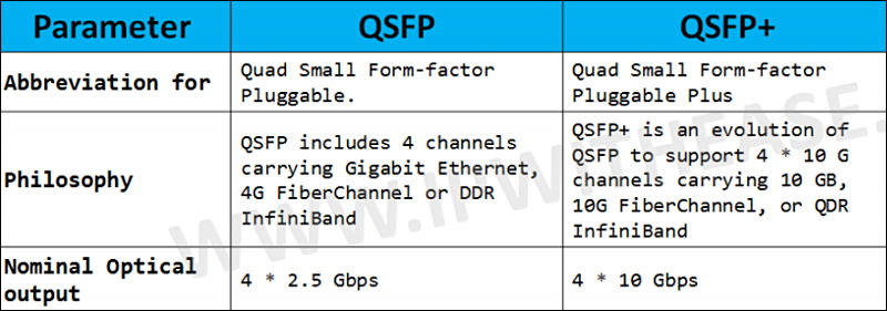

Check about Infiniband kinds at https://en.wikipedia.org/wiki/InfiniBand
Cards must have QSFP+ ports, FDR are more expensive (and faster).

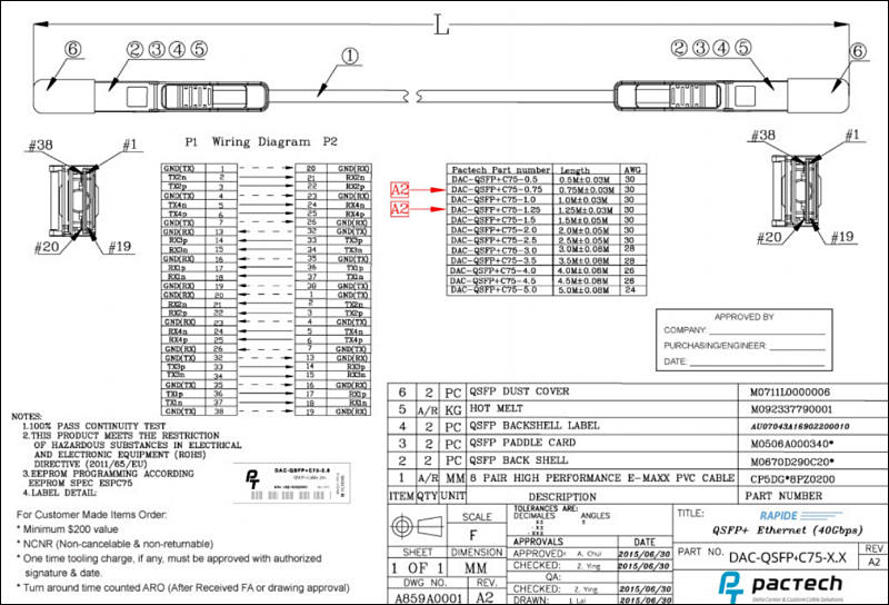

You will also need proper cable, for short distances it looks like (it is same direct soldered wires as in SFP+ case for Ethernet adapters, just more of them)
For long length you need optics:

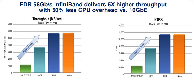

Another big thing with Infiniband - it is solution to go if you plan to use Intel Optane memory as main editing drive.
With it you can do it remotely from other machine and still get amazing IOPS and keep low latency.
Infiniband performance
