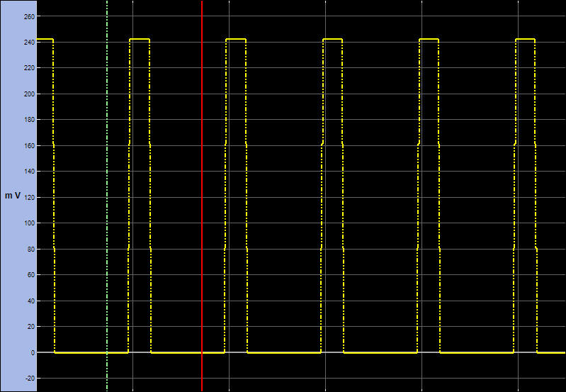

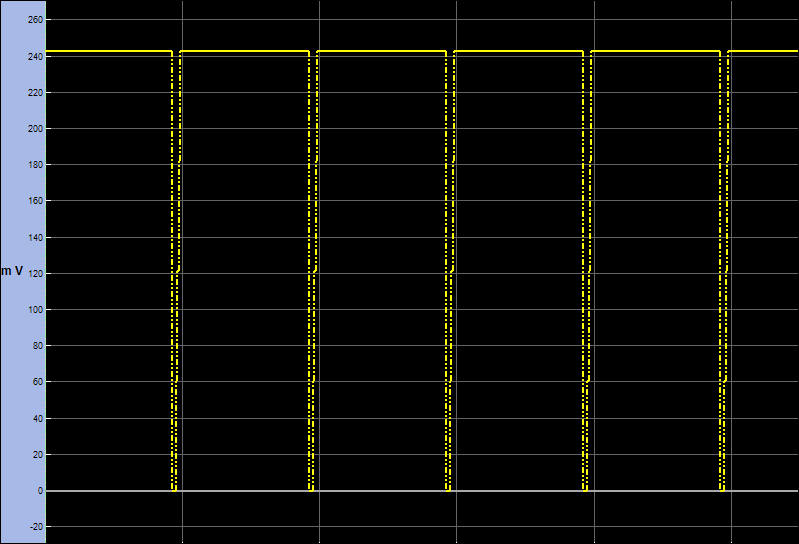

  • PWM Measurement (it is same results for B-30 and B-50)
    At minimum 20% brightness setting PWM frequency is 19.6Khz duty is 20%
    At maximum 100% brightness setting PWM frequency is 19.6Khz duty is 98%
    799 x 553 - 77K
    799 x 544 - 66K

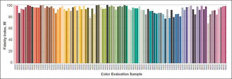

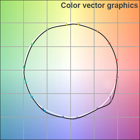

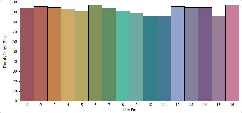

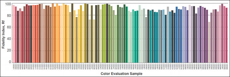

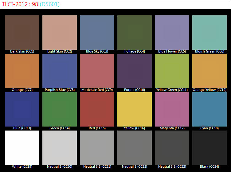

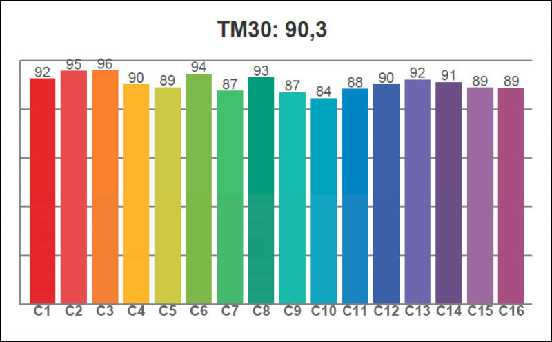

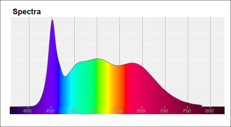

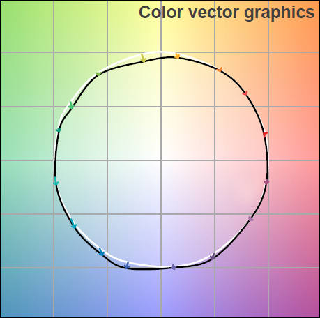

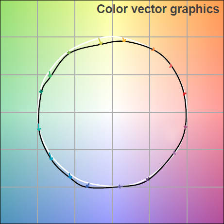

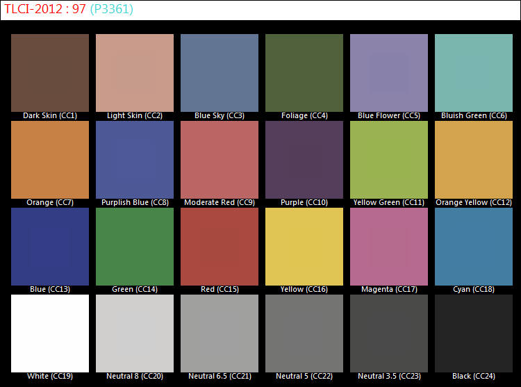

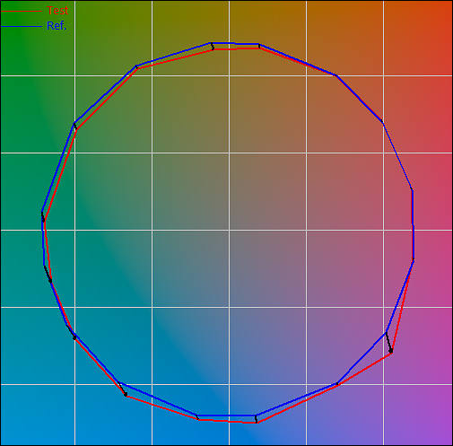

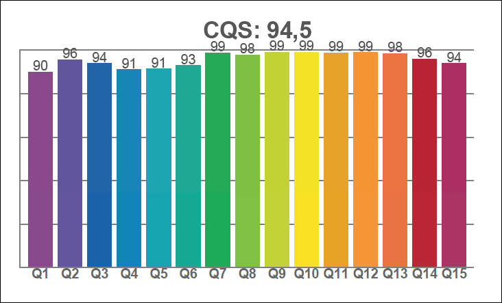

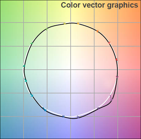

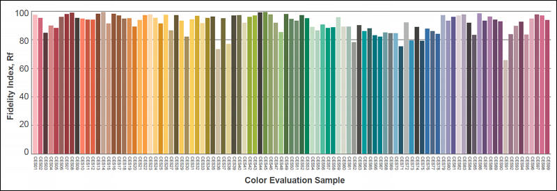

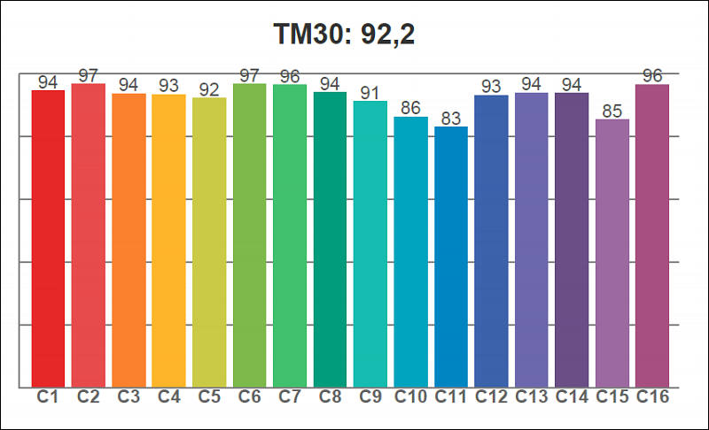

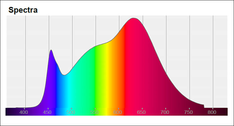

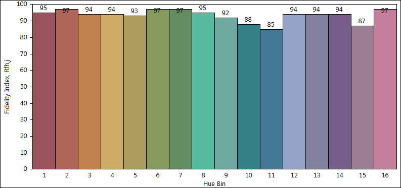

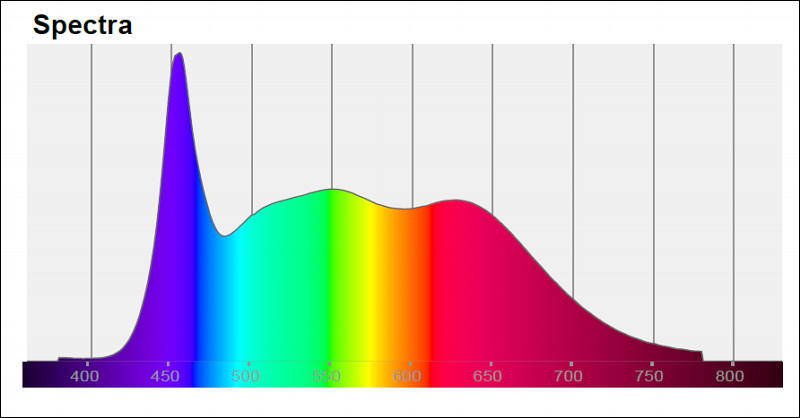

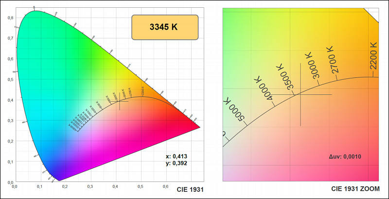

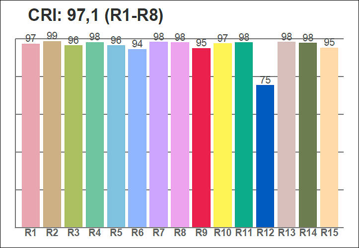

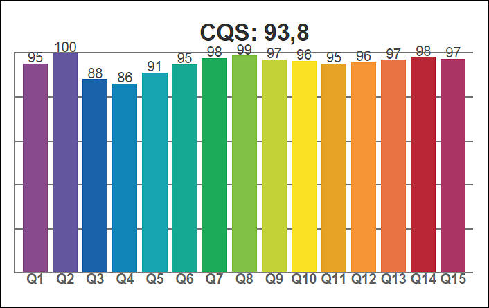

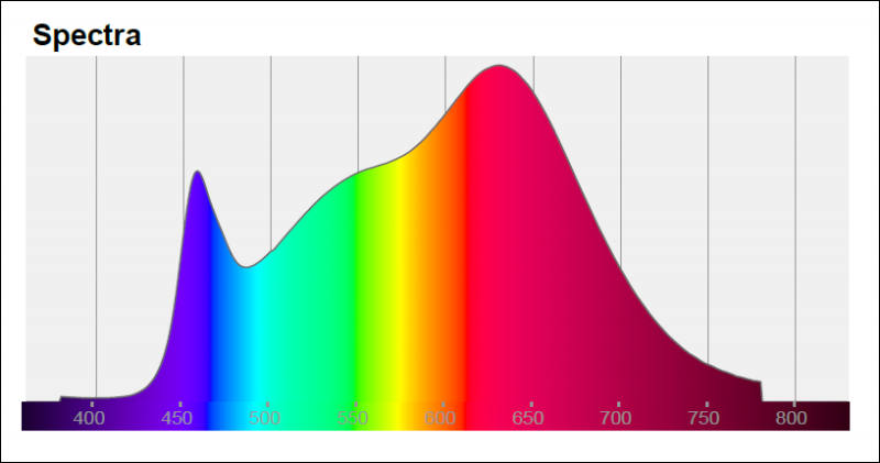

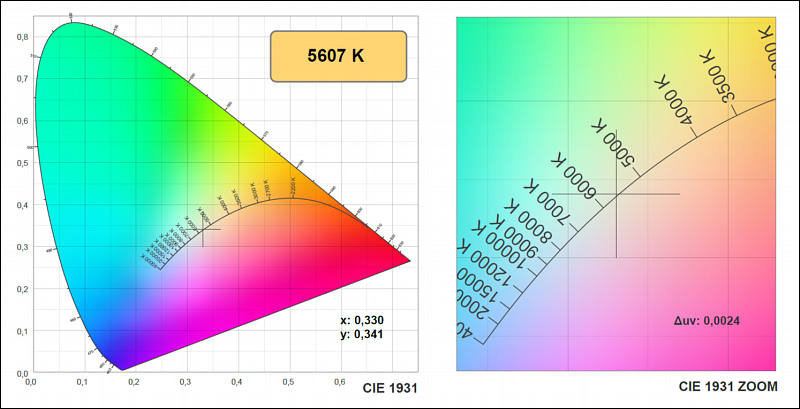

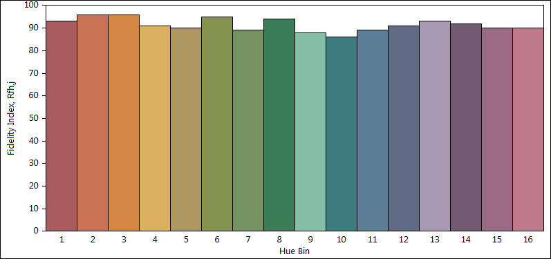

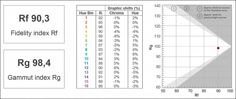

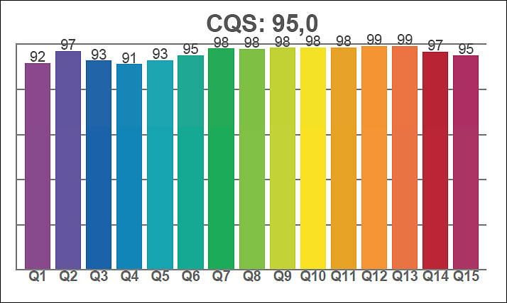

  • CAME F-55S (Bi color, tungsten setting), measurement using Lisun, Russian Lab processing
    Focus on TM30 and CIE 244 and look for color distortion and Rf values.
    CAME F-55S is good light with proper color temperature, light quality is very good and suitable for videos.
    Color temperature
    CRI color quality
    CQS color quality
    TLCI 2012
    TM30 color quality
    TM30 details
    CIE 244 2017 (Rf = 93)
    800 x 432 - 34K
    720 x 511 - 55K
    714 x 427 - 57K
    800 x 484 - 61K
    800 x 332 - 47K
    459 x 456 - 30K
    800 x 268 - 69K
    751 x 558 - 57K
    499 x 505 - 43K
    794 x 374 - 42K
    800 x 432 - 34K
    800 x 409 - 51K

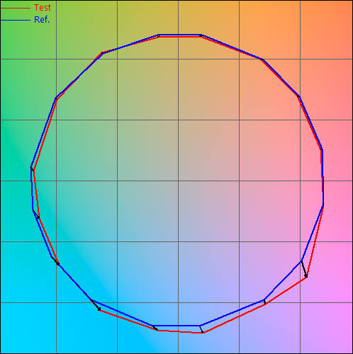

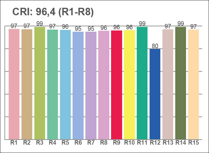

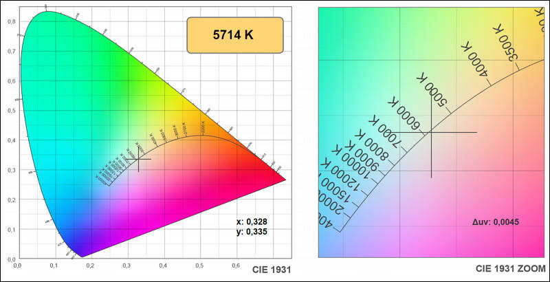

  • CAME F-55S (Bi color, daylight setting), measurement using Lisun, Russian Lab processing
    Color temperature
    CRI color quality
    CQS color quality
    TLCI 2012
    TM30 color quality
    TM30 details
    800 x 440 - 32K
    800 x 409 - 53K
    729 x 523 - 61K
    760 x 471 - 61K
    752 x 560 - 57K
    800 x 486 - 62K
    800 x 331 - 46K
    800 x 273 - 64K
    498 x 500 - 44K
    793 x 373 - 41K
    461 x 457 - 29K

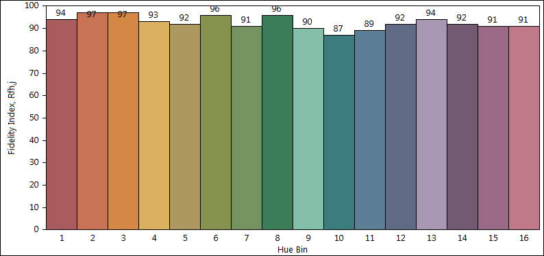

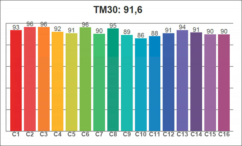

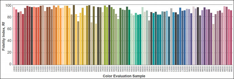

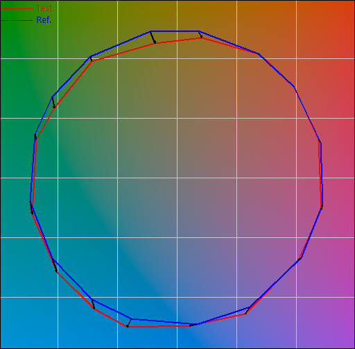

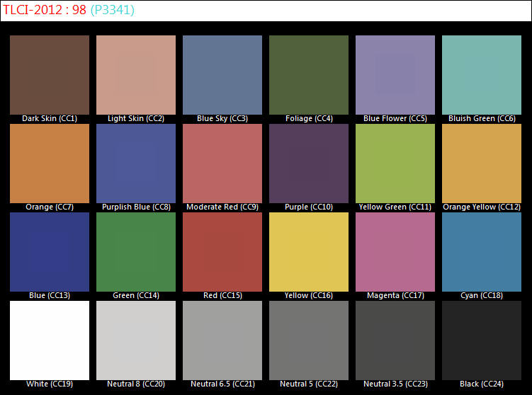

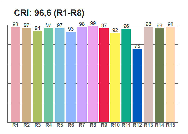

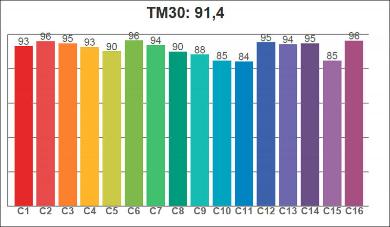

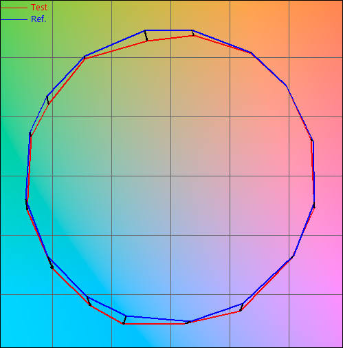

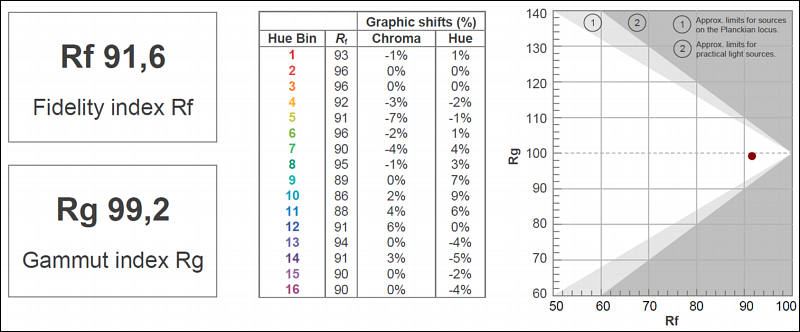

  • CAME-TV Bi-Color Boltzen 55W Led Fresnel Light
  • CAME F-55W (tungsten version), NAB 2017 measurement using CV600, Russian Lab processing
    CAME F-55W is good light with proper color temperature, light quality is good and suitable for videos.
    Color temperature
    CRI color quality
    CQS color quality
    TLCI 2012
    TM30 color quality
    TM30 details
    CIE 244 2017 (Rf = 91)
    800 x 421 - 31K
    800 x 404 - 49K
    700 x 512 - 53K
    732 x 443 - 52K
    750 x 557 - 56K
    800 x 496 - 54K
    800 x 336 - 46K
    461 x 461 - 29K
    800 x 271 - 68K
    797 x 375 - 36K
    512 x 503 - 41K
  • CAME F-55W (daylight version), NAB 2017 measurement using CV600, Russian Lab processing
    CAME F-55W is good light with proper color temperature, light quality is very good and suitable for videos.
    Color temperature
    CRI color quality
    CQS color quality
    TLCI 2012
    TM30 color quality
    TM30 details
    CIE 244 2017 (Rf = 92)
    800 x 418 - 33K
    800 x 410 - 57K
    723 x 499 - 60K
    706 x 445 - 57K
    752 x 557 - 61K
    800 x 466 - 60K
    800 x 330 - 46K
    458 x 459 - 32K
    800 x 275 - 66K
    796 x 374 - 37K
    505 x 497 - 41K

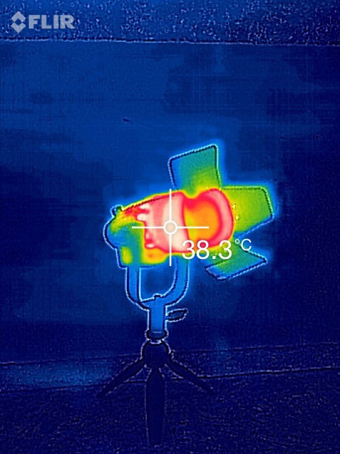

  • PV Lab report, Part 4, Thermal Test 2
  • PV Lab report, Part 4, Thermal Test 1

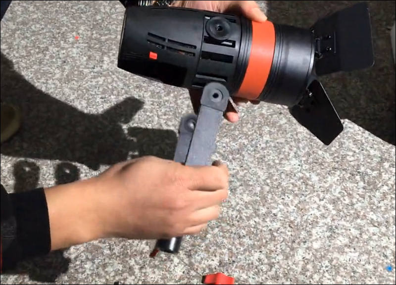

  • @Aria
    I was thinking about perhaps modifying the Bracket with Arri Rosettes to keep things in place. It's just an idea for now but maybe someone can look into that or suggest it to CAME-TV.
    They already made this up, but it is not included by default
    http://v.youku.com/v_show/id_XMjExMTEwOTc2OA==.html
