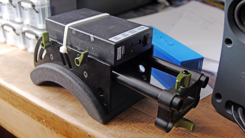

I use the LanParte shoulder pad with cheap CCTV batteries and a cable tie. Works brilliantly. 5V (sound recorder/HDMI sender), 9V (GH2) and 14V (LCD Monitor).
                  That looks very interesting. No messing around, just plug and go :)

@chainsawfilms about 6 months, maybe more.
Thanks @itimjim I'll pick up a couple of these. I take it the 9v plugs directly into the DC coupler and you're away?

@chainsawfilms I needed a tip in between the lead from the battery and the lead on the DCC8 coupler.
One criticism I have of the batteries is that they take an age to charge and don't really provide you feedback that they are fully charged. I just leave them charging overnight. At the price point, I cant really complain.
Thanks for that. I'm after a no-solder solution, this sounds like a good bet :)
