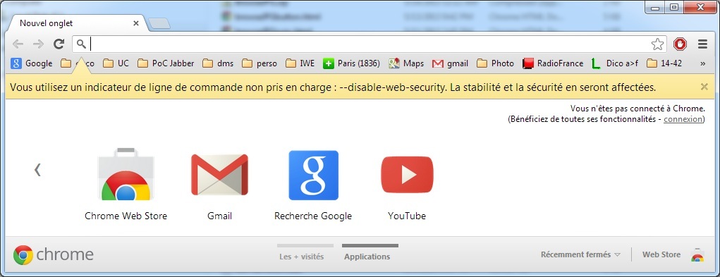

  • A small update, you can now download the JPG files stored on the GH3 using Chrome and the attached files.
    • For security reasons, the web browsers doesn't like to parse content coming from other web sites, unless the requesting web page belongs to the same domain as the requested one.
    • To make this work with the GH3, you have to launch chrome with a specific parameter : you need to use the CLI (with Windows or Mac OS), and type "chrome --disable-web-security".
    • Download the attached "BrowseJPG.zip" file, and unzip it wherever you want
    • You can then launch (from this "unsecured" Chrome page) the file "controlBrowseJPG.html" to access the files stored on the GH3
    • you will be presented with the thumbnail pictures, if you click on one of them, you will download the full res jpg.
    • FYI, 3 versions of the files are present on the GH3 :
    Edit : I forgot to change the default value of the IP address of the GH3, which is set to 192.168.0.13 (the IP@ of my GH3).
    • You should be able to change it when you launch the file (ie just change it to 192.168.0.1 before you click on load)
    • If you want to change the default value, edit the "controlBrowseJPG.html" file, and on line 6, replace the value field with the IP address of your GH3 (192.168.0.1 if you're directly connected to the Wifi network of the GH3)

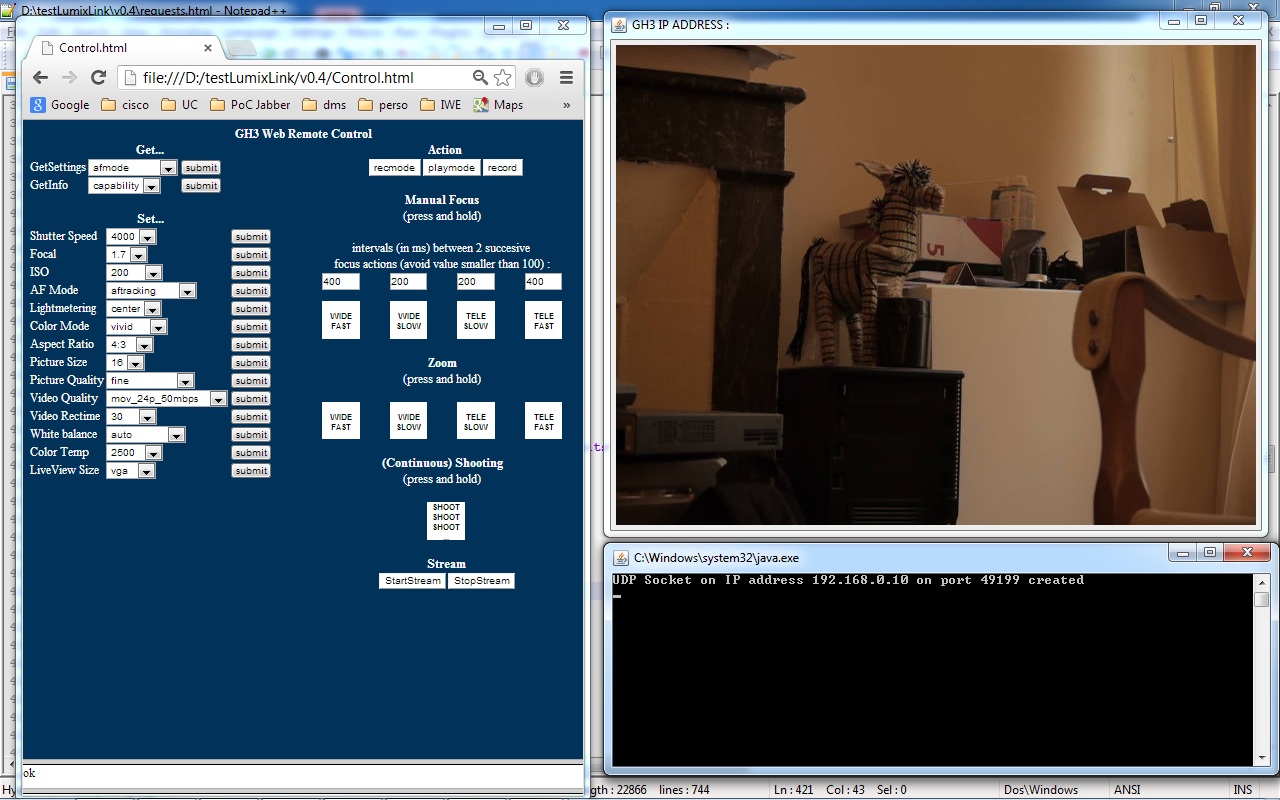

    @taawp & @Vitaliy_Kiselev I'm starting to like Java :). To enable more advanced features, the program needs to be able to retrieve/parse and send XML files from/to the GH3, and it's a nightmare using browser because the GH3 doesn't use any "Access-Control-Allow-Origin:*" in its response header, and browser don't like that. If you're interested in the topic, you can read this : http://stackoverflow.com/questions/3076414/ways-to-circumvent-the-same-origin-policy
    I think I'm going to go one with Java for a Lumix Link like application for PC/MAC. A Web UI using JS will be better to develop specific apps. But If someone is willing to spend time on a live view player for the web, the theory is really simple :
    • create a local UDP socket on port X
    • send a GET HTTP like : http://@IP_GH3/cam.cgi?mode=startstream&value=X
    • retrieve the bytes stream, look for 0xFF 0xD8, cut the datagram packet from this 0xFF offset to the end (finishing with 0xFF 0xD9)
    • convert this into a JPG and display it

    • As lenuisible explains, set gh3 on wifi> wifi function> new conection> remote shooting
    • select gh3's wifi network from airport, set password given by camera
    • start the control html file, press the "recmode" tab - gh3 reads "Under remote control"
    • then simply open "UDPServer.class" file; you can also fire the stream from a terminal window (which was my case) but it is far easier this way
    • back to firefox and control.html, press "StartStream" tab
    • watch wonderfully boring things anew :P
