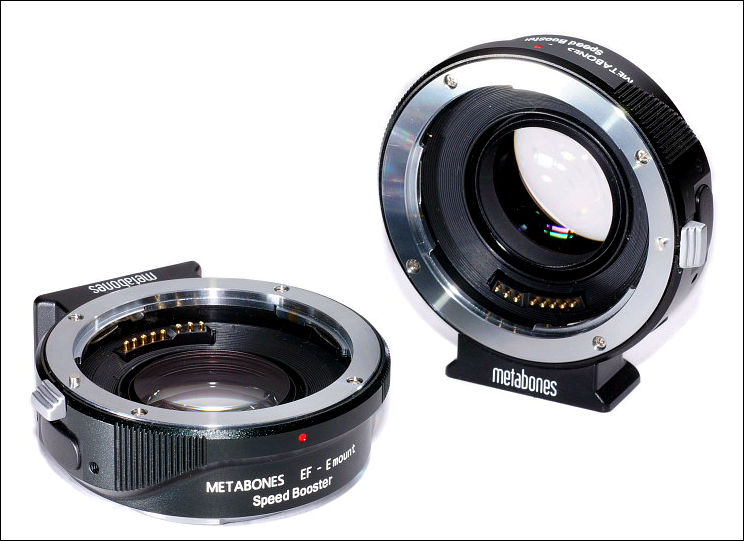

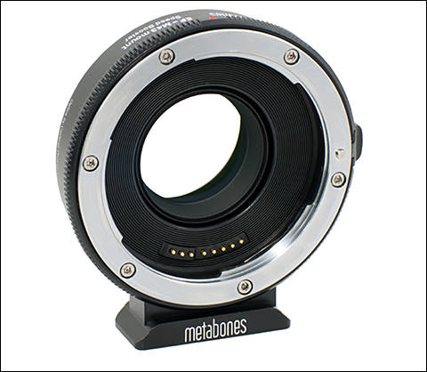

Metabones lens speed booster adapter, focal reducer
  • This is 0.71x metabones focal reducer located in the lens adapter.
    Specifications
    • Magnification: 0.71x
    • Maximum input aperture: f/1.26
    • Maximum output aperture: f/0.90
    • Lens elements/groups: 4/4
    • Objective lens mounts: Canon-EF, Nikon-F (Leica-R, Contax C/Y, Contarex and Alpa planned)
    • Capabilities, Canon-EF version: Electronic iris control, AF and VR
    • Capabilities, Nikon-F version: Manual iris control of G type lenses
    • Camera mounts: Sony NEX, Micro Four Thirds, (Fuifilm X planned)
    • Length reduction (Sony NEX, version): 4.16mm
    • Length reduction (Micro Four Thirds version): 6.17mm
    • Dimensions Sony NEX version (diameter x length): 69mm x 27mm (with tripod mount removed)
    • Weight Sony NEX version: 194 grams
    • Tripod mount: Removable type with Arca Swiss compatibility
    • In reality it is EOS to E mount adapter with glass
    • Price for Canon version is about $600
    • Price for Ninon G to m43 is about $400
