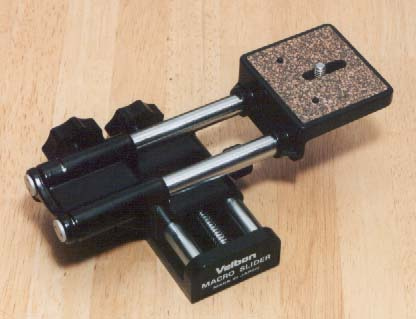

    I also recommend to buy this for indian stabilizers -
    http://cgi.ebay.com/4W-Macro-Focusing-Rail-Slider-Quick-Release-Plate-K0G-/260656473898?pt=LH_DefaultDomain_0&hash=item3cb056272a
    This thing add weight and saves your time during balancing and rebalancing.

    BTW, a good set of macro rails might help with balancing without the need to turn any bolts. I use the Velbon rails myself - picked up a set for $20 at the used camera shop.
