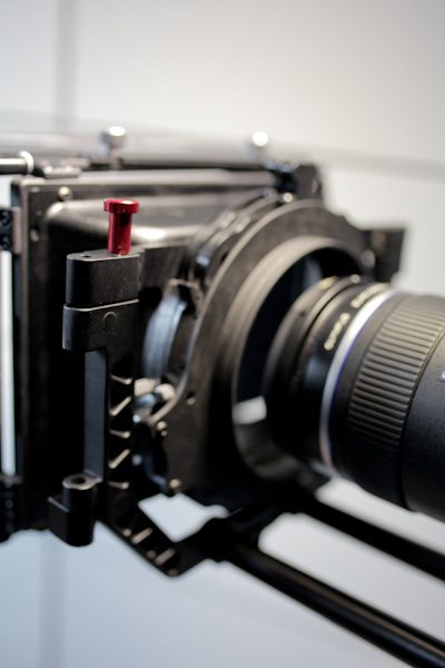

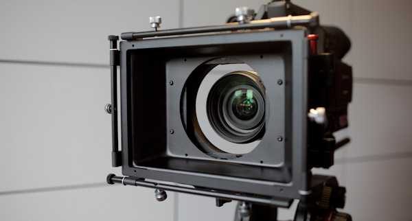

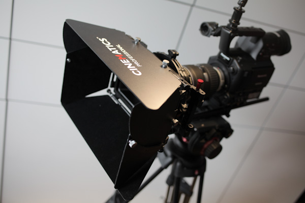

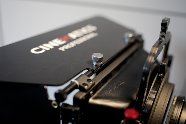

  • Just got this thing:
    Initial impressions after playing with it for short:
    I really like quality, all but filter frames and their side holding stuff are from metal.
    Feels really sturdy.
    Has four flags (top, bottom, and two side flags).
    Flags (and all mattebox :-) ) are much better than indian stuff, thicker, better made, internal sides are covered with dark velvet.
    Right now it feels like one of the best gear purchases.
    I'll later try to review it in more detail, but after more real work.
    Btw they no longer have this awful screws heads on top of inside velvet on flags, now they use proper screws with flat heads that are below velvet.

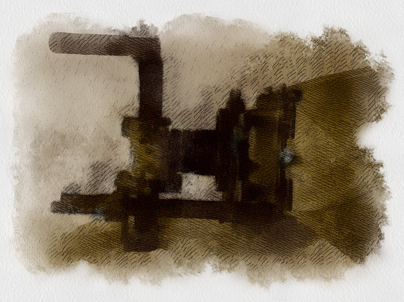

  • About relative sizes:
    792 x 593 - 139K

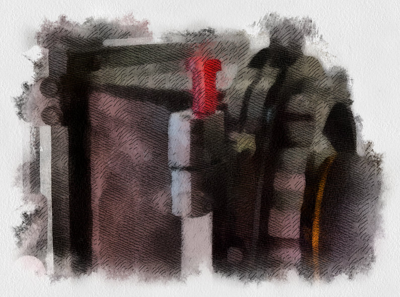

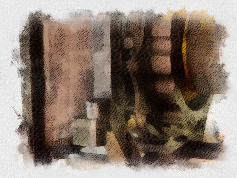

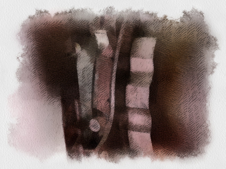

  • Issues that I found so far.
    Closing and and opening mattebox for changing lens could be better.
    First, it is quite low, so it can touch rails especially with all flags.
    Second, at locking side manufacturer use same parts as on axis side, so they can slightly touch.
    Most probably could be fixed by adjusting all screws.
    Locking side bottom:
    Frame parts could touch each other.
    Locking side top :
    Red thing can be screwed less or more (after this adjustment you just pull it up to open).
    Filter section is below overall matte box quality level.
    It has one fixed holder and one that can be rotated.
    Rotation range is limited to 180 degrees.
    Filter frames are ok, but could be much better.
    I think that Tilta has better filter section.
    Two filter folders, nearest to lens rotates up to 180 degrees:
    Filter holder fixing screw:
    It is very hard to screw or unscrew it. Frame block your fingers.
    Side flags fixing screw:
    Could be better, as flag is quite thick it is always under angle and not wide enough.
    But works ok.
    795 x 596 - 149K
    794 x 591 - 135K
    795 x 595 - 113K
    791 x 593 - 134K
    791 x 588 - 129K

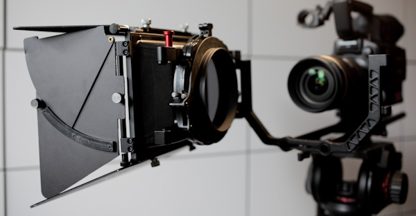

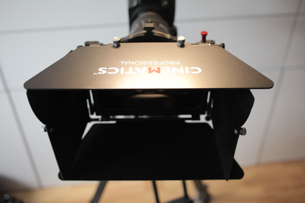

  • New mattebox from Cinematics
    This is a moderate priced mattebox in a complete package with flags all around and swing-away feature. Asking price is about $500 including shipping and that has to be considered a decent price for a mattebox. Three years ago I got a small Proaim mattebox that has worked during the early days of DSLR shooting. Quality wasn't to great but it held my filters and provided some shade. One of the reasons I got one was to make a DSLR look more like a film camera. But you can use a rubber lens hood as a lens shade way cheaper than getting a mattebox so this must no be the sole reason. Then again the times you need filters a mattebox is just the tool to use.
    The top/bottom and side flags are in metal and of thick metal with velvet on the inside. These pop in and you tighten knobs to have them securely attached. Two things that I dislike with these are firstly the way the side flags extends. The sliding mechanism isn't the greatest. Secondly, the flag knobs for fastening and It's position has a placement that makes it somewhat hard to tighten or loosen.

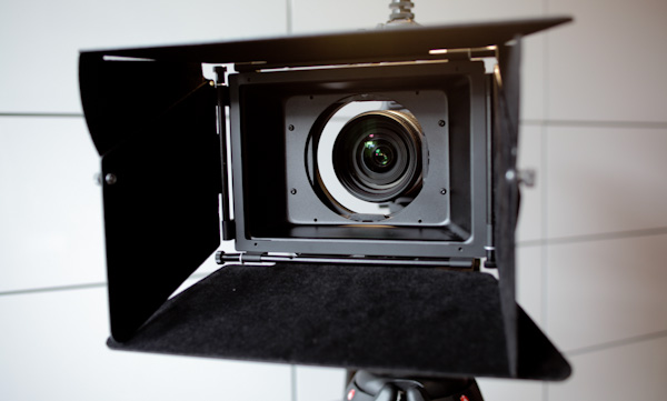

    Most parts are in metal so it seams it will be a robust mattebox. The mattebox part is all metal but there's no matt inside, just a big round hole to the lens. Filterholders are for 4x4 filters and the one nearest the lens is stationary while the other one is rotatable. These are in plastic and just as poor as the ones you get with a PROAIM mattebox. Something better would definitely be holders that comes with shoot35 mattebox. It doesn't rotate to well and is not the smoothest to take in or out. There's no problem using this at least as wide as 14mm without the mattebox obscuring the image. This with my AF101.

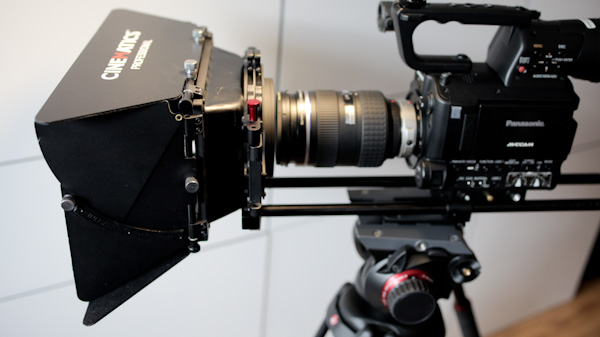

    A thing I like is how the swing away assembly is constructed. When in locked position the mattebox rest at both ends so there's nothing moving. You lift the red pin and swing it out to swap lens. It's not the greatest fit but okay thanks to the use of metal parts.
    When mounted on rods I would recommend to have it at the end of rods. If you slide it in you will hit the rods when using the swing away feature. This is because the lower flag holder is in the way. You can take it away if you don't need a bottom flag and thus the problem can be resolved.
    I have some mixed feelings about the Cinematics mattebox. It's better than a PROAIM mattebox but some things are missing like a matt inside the box. It does look cool on the camera but hey it has to work also! And it does work but maybe not as smooth as I'd like it to. I will put it to use and see how it performs before deciding.
