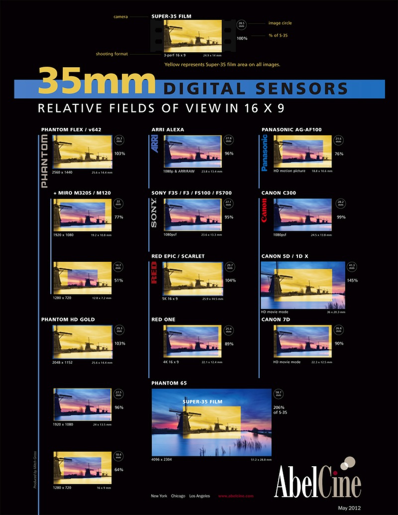

  • Another handy little guide, from my friends over at Panavision.
    600 x 514 - 40K
  • LOL, Panavision too busy with dinosaur and $ilverscreen taxonomy to note furry M43 mammals scurrying about?
