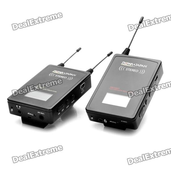

It has stereo mic inpuit and stereo line input.

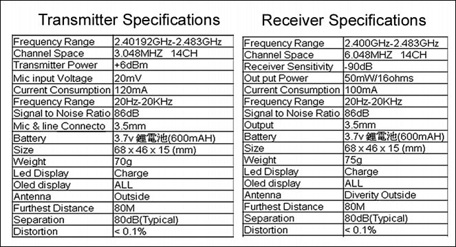

Looking at short manual parameters are quite good (as it uses digital transmission).
"Powered by 1 x 3.7V / 710mAh lithium battery"... Any idea what battery that is? Something built in I guess?
No. Spend few seconds, click on a link. It is NB-4L battery. Available on ebay in wast quantities for about $2-3.

I would be curious about the reviews. ALL the cheap wireless mics I tried sucked so far. Transmission is not digital. Its analog over a 2.4GHz spectrum. Lectrosonics is the only with with a digital transmission. They conver the analog signal to digital before sending it out and decode it on the other end,
I suggest you to try Line 6 systems. As far as I talked to owners they are very good (fully digital). But they don't have any on camera solutions.
Can you tell me source of your information?
None of the specifications say this.
Their home page has "complete digital wireless stereo microphone system"
Same on the cases "digital wireless system".
Looking at 86db SNR and 80db stereo separation it also looks like digital specs.
Of course it can be not entirely true, we'll see :-)
It is also wrong. As Line 6 systems exist for years that are very advanched digital systems working in same 2.4GHz range.

I guess sound quality of these Rowa's will be good, and it looks like you can power them with 5V from your rig, and there is a separate headphones out as well as line out (volume adjustable to GH2 input levels?). So at first sight this looks very good for a set that costs less then $ 200.
So it could be a great alternative for those expensive TxRx sets or even the current $500/600 Sennheiser sets. At this price, the real interesting thing is if the wireless reception is good enough for avarage use. Do you know if those Line 6 owners use their system at run&gun location work, or only fixed positions? Both are 2.4 GHz digital diversity systems so I guess they'll hold up the same? It would be interesting, as I am looking for an extra set as well.

btw: More details on the Rowa here: http://www.rowa.tw/EN/goods.php?id=877
