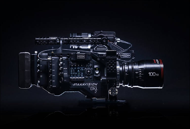

Panavision Millennium DXL2 8K http://www.personal-view.com/talks/discussion/18925/panavision-millennium-dxl2-8k Fri, 02 Feb 2018 13:08:56 +0000 Vitaliy_Kiselev 18925@/talks/discussions image
Panavision (Stand 502) is introducing the new Millennium DXL2 8K camera here at BSC Expo 2018, running Feb. 2-3 at Battersea Evolution. The large-format camera is the heart of a complete imaging ecosystem designed from filmmakers’ perspectives, seamlessly incorporating Panavision’s unmatched optics and camera architecture, the RED MONSTRO 8K VV sensor, and Light Iron color2 science (LiColor2). The DXL2 builds on the success of the Millennium DXL and benefits from Panavision’s unique and storied partnership with cinematographers, whose real-world experience and input are manifested in the DXL2’s many significant advances.
“The Millennium DXL2 8K camera system was conceived with the goal of maximum creative control from the moment of capture through delivery and display,” says Michael Cioni, senior VP of Innovation at Panavision and Light Iron. “Panavision’s vast inventory of advanced large-format and anamorphic optics combined with RED’s MONSTRO imager expands what’s possible, allowing filmmakers to create radically inventive and powerfully cinematic images, customized for the needs of the project and the vision of creative teams.”
As a camera and lens manufacturer that also serves filmmakers as a trusted rental house, Panavision is uniquely positioned to respond to the needs of the community. Since its introduction, the DXL has been used on over 20 feature films, and countless television shows, commercials and music videos. Oscar® nominee John Schwartzman, ASC photographed two features on the DXL and is among those who have tested the DXL2, providing input that has guided the design.
Schwartzman says, “When you take an 8K image and super-sample it, it only gets better. It’s absolutely beautiful to look at. For me, the Millennium DXL2 is a no-brainer. It’s something I would use on anything. It does it all. And in fact, I’m currently planning to shoot my next feature with it.”
The RED MONSTRO 8K V V sensor in the DXL2 offers a healthy 16-plus stops of dynamic range with improvements in image quality and shadow detail, a native ISO setting of 1600, and ProRes 4K up to 60 fps. Images are presented on the camera in log format using Light Iron color science. An integrated PX-Pro color spectrum filter custom-made for the DXL offers a significant increase in color separation and dramatically higher color precision to the image. Built-in Preston MDR, 24v power and expanded direct-to-edit features are also standard equipment on the DXL2. An anamorphic flare attachment (AFA) offers a convenient, controllable method of introducing flare with spherical lenses.
New to the DXL2, LiColor2 (Light Iron Color) streamlines the 8K pipeline, smoothly handling the workflow and offering convenient and quick access to high-quality RAW images, accommodating direct to edit without delays.
“We are proud to provide an ecosystem of tools that gives filmmakers more choices to express their vision,” adds Panavision CEO and President Kim Snyder. “We have been listening to feedback from cinematographers and the results of our collaboration are directly manifested in the DXL2. We remain committed to continuous technological development and are excited to bring this new camera to market.”
The Millennium DXL2 will be presented at the Panavision booth (Stand 502) alongside a showcase of the company’s large-format and anamorphic optics, as well as the latest products and solutions from Panalux, Light Iron and Panavision Grip and Remote Systems.
Also at BSC Expo, Panavision presents “The Beauty of Large Format 8K” at 14:00 on Feb. 2 in the seminar room. The session will offer a preliminary introduction to the DXL2 while taking a deep dive into the relationship between resolution and large-format optics. Michael Cioni will guide the discussion and present clips that demonstrate the benefits of 8K capture and how ultra-high resolution equates to creative control with smoother imagery.
DXL2 cameras are available now to rent exclusively from Panavision on a worldwide basis.

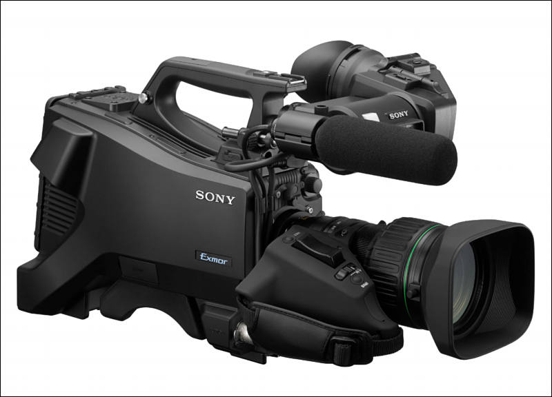

Sony HXC-FB80 ENG Camera http://www.personal-view.com/talks/discussion/18010/sony-hxc-fb80-eng-camera Tue, 17 Oct 2017 04:25:38 +0000 Vitaliy_Kiselev 18010@/talks/discussions image
Sony is offering an accessible entry into 4K- and HDR-ready studio and live production with the combination of the new HXC-FB80 portable camera and HXCU-FB80 camera control unit (CCU). Based on a 3G-SDI platform with 1080/59.94p capabilities, the new system fits a range of commercial applications where professionals need high-quality HD with a “future-proof” path to 4K and HDR production.
The HXC-FB80 expands Sony’s HXC product line-up and shares many common features with the current HXC-FB75. The new camera continues to provide signal-to-noise ratio at -60dB with high sensitivity of F13 at 50Hz or F12 at 59.94Hz – ideal for low-light shooting and a variety of camera painting and processing capabilities.
The CCU up-scales HD content to 4K (3840×2160) and provides a 12G-SDI output in addition to a quad-Link 3G-SDI. HD-HDR support for Hybrid Log-Gamma (HLG) will be available in summer 2018 through a free firmware upgrade.
Since its debut, the HXC series has been adopted worldwide for diverse uses. This new camera system is based on customer input and the added support for up-scaled 4K and HD-HDR production expands the system to a wider range of applications.
The HXC-FB80 has the same choice of configurations as the FB75 series: the HXC-FB80HN (camera body only), HXC-FB80KN (with 2/3” HD Lens, Portable viewfinder and Microphone) and HXC-FB80SN (with 2/3” HD Lens, Large viewfinder).
The camera has three 2/3-inch type CMOS Exmor image sensors and provides 59.94Hz progressive operation at 1080×1920 between the camera head and CCU using a 3G platform. The camera also supports 23.98PsF shooting for productions requiring a “cinematic” look, such as live events and other applications including interviews and newsmagazine-type programs, along with 25PsF or 29.97PsF shooting.
The ND filter can be remotely controlled by the newly adopted filter servo motor in the camera head in addition to the electrical CC filter.
The potential distance between the camera head and CCU is extended up to 600m (approx. 1970 feet), while keeping the 10km (33,000 ft.) extension by single mode fiber cable with local power supply. Together with the HXC-P70H, the cable length can be extended up to 1,000m (3280 ft.) with the supplied power from the new CCU.
In addition to a Neutrik connector interface, a LEMO connector interface is an available option for the camera head and CCU.
The HXC-FB80 system can be controlled not only by the CCU front panel operation, but also RCP remote operation including PC-RCP (HZC-RCP5) and Master Setup Unit (MSU) system for multi-camera application, which ensures scalability of its system.
The HXC-FB80 camera and HXCU-FB80 camera control unit are planned to be available in January 2018. Sony will be exhibiting the new system at the NAB Show New York, October 18-19, booth N401.
