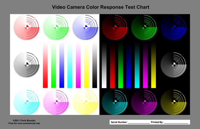

GH2 Hack Technical Tests http://www.personal-view.com/talks/discussion/753/gh2-hack-technical-tests Wed, 24 Aug 2011 14:12:57 +0000 cbrandin 753@/talks/discussions
To accurately measure quality improvements you have to see how footage reacts to the processing that takes place when it is converted to the RGB domain - in other words, when it is rendered. For these tests I used this chart:
In order to make the effect of the raised quality reatures most visible I set AQ to 4 (all to detail) for these tests. Frame grabs were exported in a lossless format to Photoshop. In Photoshop, I used levels to examine image portions in a restricted range in the shadows. Photoshop interpolates values within this range to produce the final image. The quality of that interpolation is very dependent on the quality of the image. It's very similar to how any kind of editor will work. As a reference I also took a still image of the chart using the highest quality the GH2 can prduce and processed the raw file. Following are histograms taken from these processed images. The lines in the histograms show quantization artifacts - you can actually see how fine (or coarse) the quantization is. This relates directly to image quality, and how far you can go with post processing and still have a good image.
Still Image:
Factory Firmware at 24H:
24H set at 44M with AQ=4:
24H set at 66M with AQ=4
As you can see there is a significant improvement at 44M and an additional, but not as big an improvement at 66M (mostly in the deep shadows).
Chris]]>
