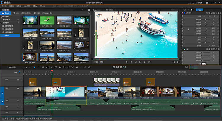

Meet VisEdit - new Chinese NLE http://www.personal-view.com/talks/discussion/21970/meet-visedit-new-chinese-nle Mon, 29 Apr 2019 01:42:46 +0000 Vitaliy_Kiselev 21970@/talks/discussions image
http://www.hkvisdom.com/index.php/product/visedit/
  • Support AV/MP4/MPG/M2V/MOV/MP2/WAV/MP3 import;
  • Support import of H.264 encoded MP4/MOV file recorded by DJI UAV, GoPro, iPhone, and other devices;
  • Support import and export of TGA/PNG/PSD/BMP/TIFF/GIF and other image files;
  • Compatible with VisTitle title and animation files (*.vtlayout, *.vxmovie);
  • Support import and export of broadcast-level encoding formats, such as GrassValley HQ, GrassValley HQX, QuickTime MOV, Avid DNxHD, H.264, MPEG, and Matrox AVI;
  • Support XML import and export of Final Cut Pro/Final Cut Pro X standard, and exchange timeline editing results with professional NLE software such as EDIUS, Final Cut Pro, Adobe Premiere, and Avid Media Composer;
  • Compatible with HD 720p, HD 1080i, and 4K program production, support portrait screen editing;

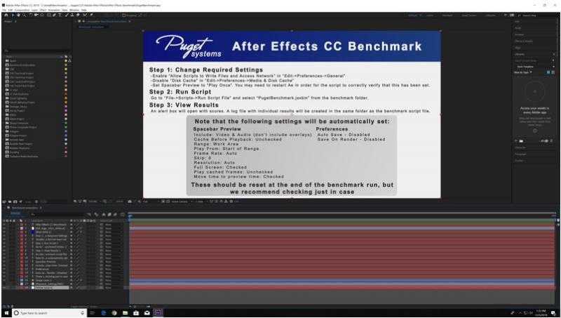

Adobe After Effects CC Benchmark http://www.personal-view.com/talks/discussion/21135/adobe-after-effects-cc-benchmark Sat, 15 Dec 2018 02:49:54 +0000 Vitaliy_Kiselev 21135@/talks/discussions image
https://www.pugetsystems.com/labs/articles/Puget-Systems-Adobe-After-Effects-CC-Benchmark-1287/
Please be very careful with such benchmarks as they are made by top custom systems sellers, so they adjust them accordingly to put as much memory usage and stress as possible. In your reality it can be that it is all simple money waste.
